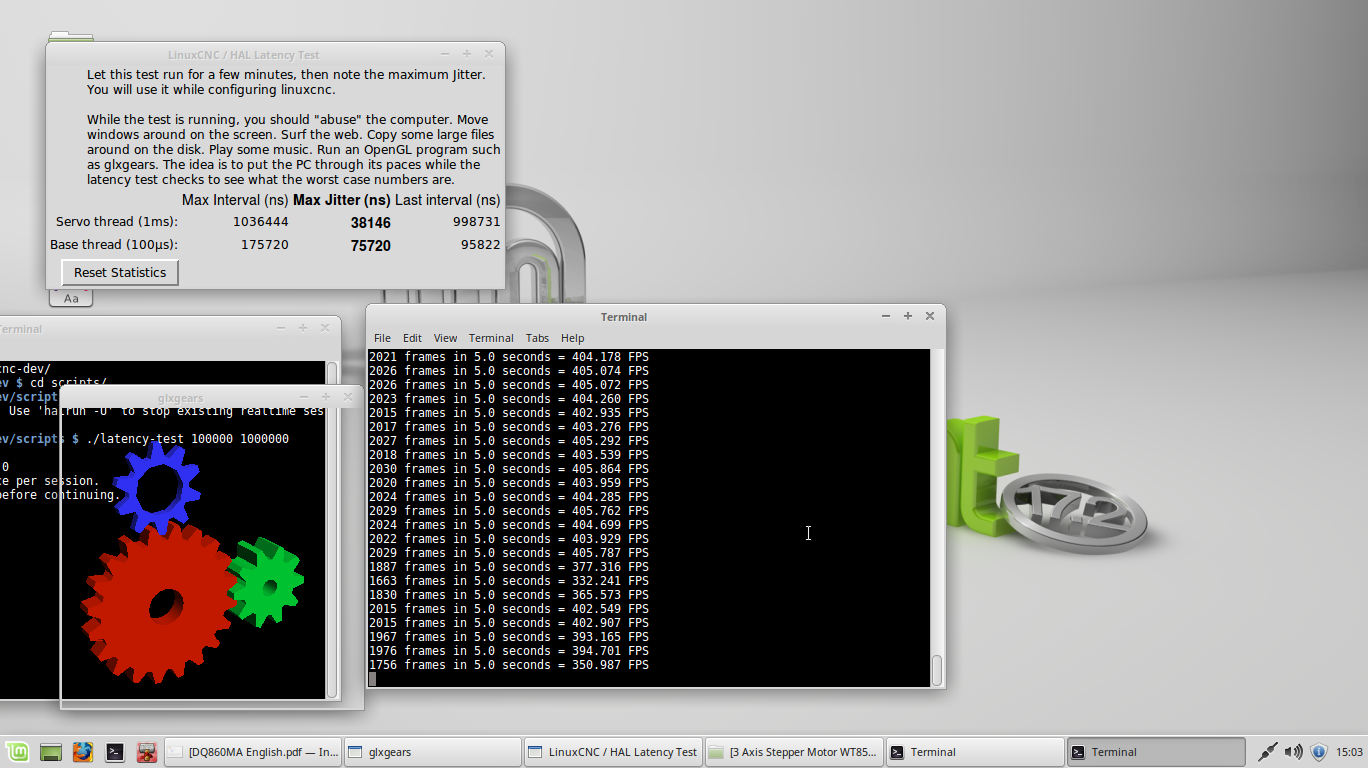

I would first try the latency test with the base thread disabled,
since this is the environment (servo thread only) that you will be running with hm2_eth:
latency-test 1000000 1000000
or:
latency-histogram --nobase
400000 (.4 ms) might be barely OK but you wont know till you try
if you cannot improve this with BIOS settings or a more recent kernel
(current Preempt-RT is 4.4.1-rt6) you could probably use a 2 ms servo thread
or:

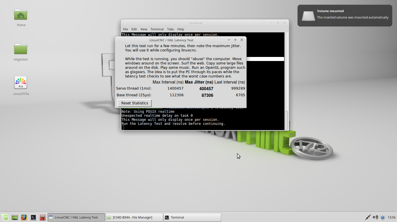

My ASROCK Q1900m-PRO3 does much better than that with Preempt-RT about 15us (and with RTAI it's even better). Are you sure you have all the power saving "features" disabled in the BIOS?

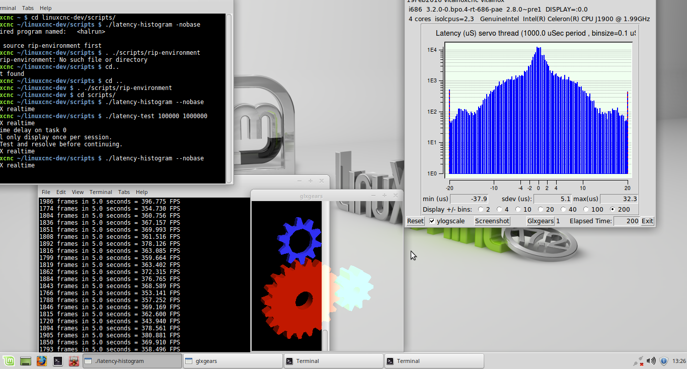

I also have a Q1900 mb and "turning off" 3 cores in linux made a big difference for me. I don't remember how I did, but it should not be too hard to find.

You can install a new Preempt-RT kernel fairly easily in most systems, but it looks
like your servo thread only latency is fine for a 7I76E at 1 KHz servo thread rate
Note that if you are running a non-parallel port system, latencies are much less important.
you definitely dont want to disable any cores if you are running external stepgens/encoder counters,
as that will just make the system slower, and on real time uspace Ethernet systems will
typically increase the network latency

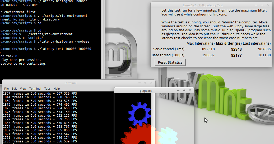

I have a Asrock Q1900M motherboard and the 1ms servo thread is less than 3570ns with the 25ms base thread at 13624 running two instances of GLXGears.
I have turned all the C state stuff, onboard audio off in the bios. and I am using a ssd hard disk
I installed linuxmint LMDE2 mate 64 bit edition and followed TJ's install here forum.linuxcnc.org/forum/9-installing-li...debian-8-mint-lmde-2
The kernel I am using is 3.18.13-rt10mah with kernel parameters of isolcpus=2,3 intel_idle.max_cstate=0 processor.max_cstate=0

Yes I am using the on-board graphics card and allocated 512K memory for it.
