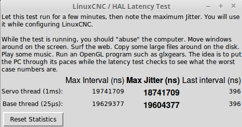

After some trouble I managed to install Linux Mint, Preemtive RT and compile linuxcnc. Touch screen works fine, but it is always a new problem. Now the latency is sky-high. On Debian with preempt it was around 20 000 if I remember correct, now it is almost 8 000 000. I have tried to turn off 3 out of 4 cores with "echo 0 > /sys/devices/system/cpu/cpu1/online", but no difference. I have no idea where to look to improve this now
uname -a = Linux FS3MG 4.1.5-rt5 #3 SMP PREEMPT RT Tue Jan 3 18:25:07 CET 2017 x86_64 x86_64 x86_64 GNU/Linux
I'm using a Asrock Q1900DC-ITX mother board.
Any one having any idea???

Disabling the power saving stuff in the bios can help. I've seen similar latency when using the on board wifi on a J1900 PC. Replace it with a USB wifi dongle.

I'm afraid it is turned off already and I do not use WiFi.
I remember when I installed Debian the first time it made a big difference to turn power saving off. Had latency around 80 000, but this is a factor 100 times higher.
I though I found something yesterday and recompiled the kernal again, but it got even worse.
I have found that one shall activate CONFIG_PREEMPT_RT in xconfig, but I can not find that parameter. My previous attempt was to activate PREEMPT_RT_FULL, and now I have tried PREEMPT_RT_LL, that I hoped should do the trick, but it did not.
Shall I try an other version of the Kernal? I'm so far off with the latency now so small changes does not help. Now I'm off with a factor of 1000! With Debian I have around 20 000 and now it is 20 000 000
The worst thing about this is that it takes so long time to try things.

Forgot to say that latency now is with one processor. With four the cpu's latency is about the same as my previous attempt around 8 200 000
