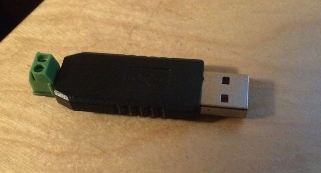

I have swapped my Lovato 3hp VFD for a Huangyang 4hp VFD as the Lovato had no RS485 protocol definition, and over-currented when running my lathe spindle motor. The HY VFDs have an already-written HAL component for control.
Using a USB RS485 dongle it turned out to be far too easy to get the spindle turning, so I decided that I would make things more difficult.
The USB dongle looked like this and cost a couple of £ from eBay.

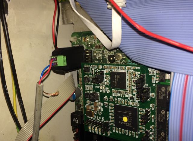

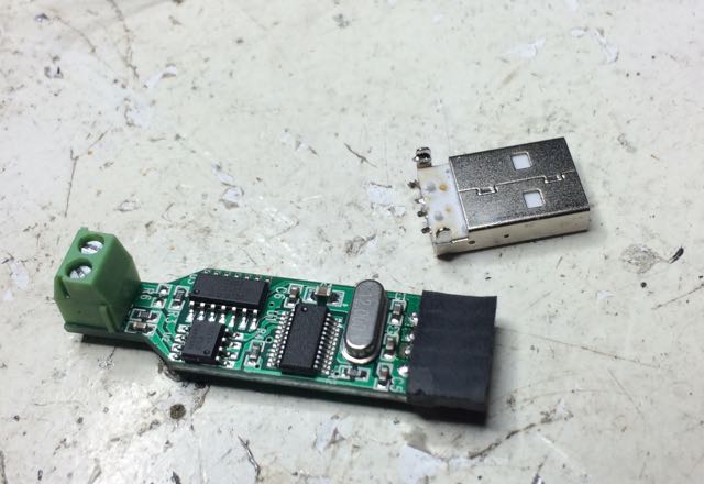

It stuck a long way out of the computer, and didn't really suit my installation, where the motherboard is simply fastened to the back of the control cabinet of the lathe. I decided to try to connect it to one of the motherboard headers.
Fortunately the USB connector pin ordering is the same as the motherboard header (probably not a major surprise) so I was able to solder a bit of header strip (with the pins bent through 90 degrees) onto the dongle in place of the USB plug.
And then I could mount the whole thing on the motherboard, saving a USB connector and also avoiding several DB9s (which all the other options seem to require).
I intend to replace the screw terminals too, so that I can have a gnd/shield on the cable.

That is a great idea! I just replaced my motherboard and space is tight. Which one did you buy? I wonder if "most" usb / RS485 dongle's will work?
This will free up a serial connection and make this a more "clean" installation. I found the Huangyang VFD was picky about it's Modbus connectivity with a ground ran from the RS485 to the VFD. So I cut the ground wire from the RS485 and only connected the ground to my VFD. I had multiple failed errors during operation until I did this.
