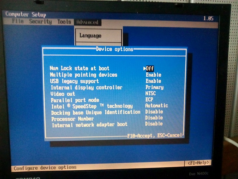

Is it possible to enable LAPIC in the system BIOS?
- ViktorP
- Posts: 3
10 Nov 2016 14:58 #82661
by ViktorP
Replied by ViktorP on topic Cannot enable Local APIC
Unfortunately, it is not possible. The BIOS setup is only very simple. See the screenshot.
