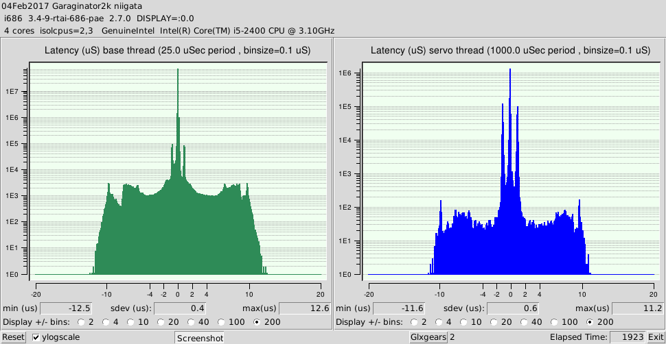

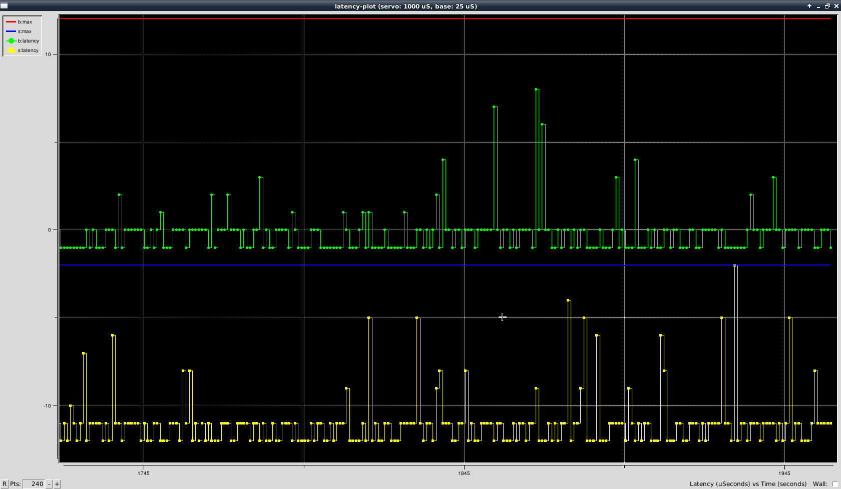

05 Feb 2017 00:03 - 05 Feb 2017 00:04 #87318
by dberndt
Replied by dberndt on topic HP Compaq 6000 pro - Multi-processor issues?
Well I fiddled with it some more. Still happy, but I haven't found any settings that really improved anything by a noticeable amount in either software or bios.
I've attached a plot and histogram screenshot. I'm open to suggestions, but may call it good enough soon and move on to ordering Mesa boards and mounting this machine in the control cabinet.
