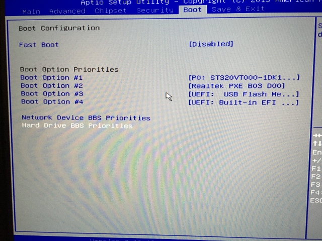

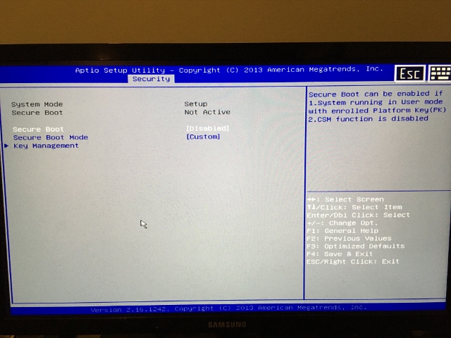

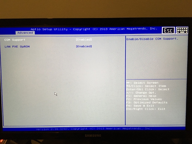

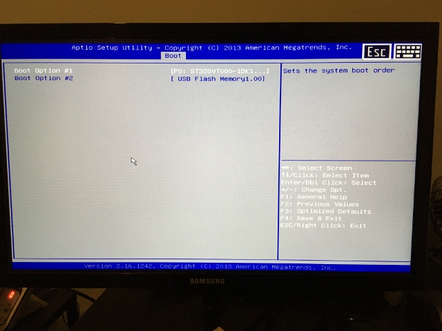

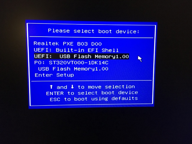

27 Nov 2020 22:07 #190483
by smplc
Replied by smplc on topic Chromebook and LinuxCNC
Experiencing some difficulty accessing LinuxCNC. It's been about a year since I booted to Debian 9 and opened LinuxCNC Axis a lot of times. Equipped with a Gigabyte GB-BXBT-1900, Ubuntu 16.04 LTS OS and USB Debian 9 Stretch LinuxCNC PREEMP. I think it's the very USB stick before booted to Debian 9. I think upon powering on the computer the BIOS was intercepted with F12 and a selectable boot drive which, is UEFI: USB Flash Memory1.00, enter and sent the GNU GRUB. I was only able to get to the GNU GRUB two out of many times recently and accidently went to Ubuntu instead of Debian 9. I think was suppose to select `C', press any key and boot to Debian. Would you know why not getting to the GNU GRUB screen often enough bye chance?
- smplc
- Posts: 224
28 Nov 2020 00:32 #190488
by smplc
Optionally resetted the CMOS.
I did get into the GNU GRUB by repeatedly pushing the Shift key upon powering on.
Could of the 'Advance options for Ubuntu' and 'Ubuntu, with Linux 4.10.028-generic' been selected but 'UEFI: USB Flash Memory1.00' didn't send to GNU GRUB. Selecting 'Ubuntu, with Linux 4.10.028-generic' boots to Ubuntu 16.04 LTS OS. The Ubuntu desktop appears okay.
Still can't boot to Debian 9.
