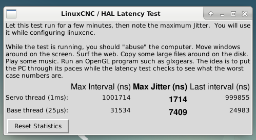

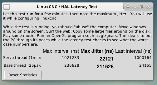

so i have one of these chinese NUC htings with a J1900, similar to this: www.ebay.com/itm/162546020408
And run the latest version of www.linuxcnc.org/testing-stretch-rtpreempt/
And get this times initially
and after 4 hours of glx gears.

13 Aug 2017 18:40 #97429
Replied by rodw on topic Cheap J1900 computer that worked kinda well.
That is way better than what I get from my Gigabyte one!

14 Aug 2017 06:20 #97446
by Moronicsmurf
Replied by Moronicsmurf on topic Cheap J1900 computer that worked kinda well.
Right u used a Gigabyte nuc one.. This is a cheap chinese one with 8Gbs of ram but still, good numbers. that max jitter is maybe so so, but if using a mesa card i think it will be fine on a plasma machine. =)

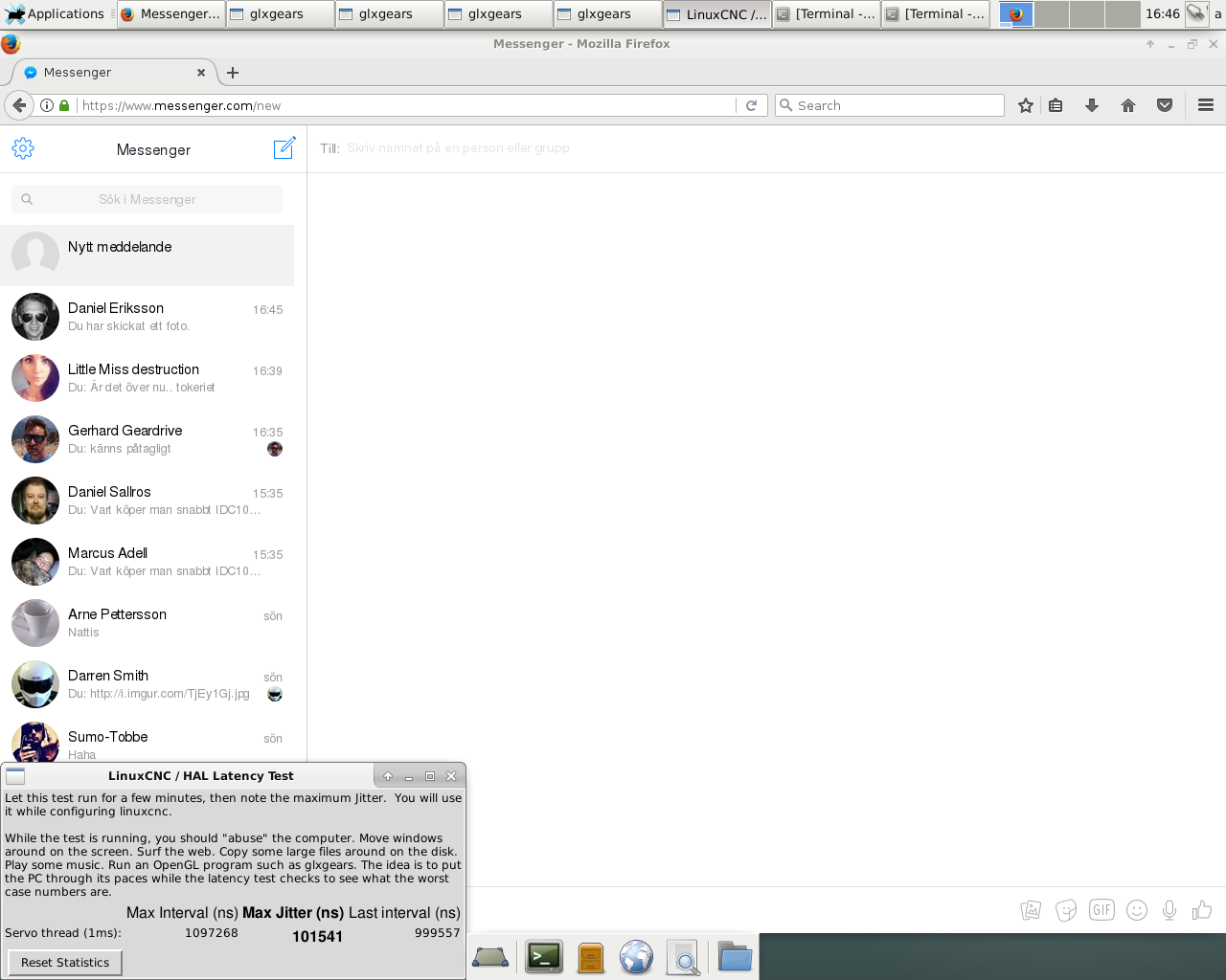

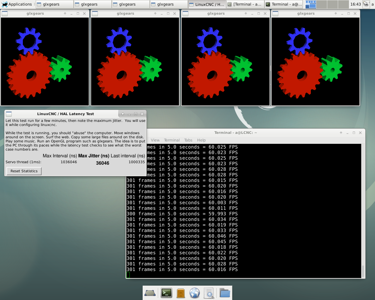

14 Aug 2017 09:48 #97453
by Moronicsmurf

14 Aug 2017 10:03 #97454
by Moronicsmurf
I do find it go up to about 190.000 or so if i fiddle with say display sizes and turning on and off power settings for some reason..

14 Aug 2017 10:21 #97456
Replied by PCW on topic Cheap J1900 computer that worked kinda well.
In general all power management needs to be disabled in the BIOS setup for decent real time performance.
That includes clock speed switching, C states above C1, AMD Cool and Quiet mode etc etc

14 Aug 2017 10:46 #97461
by Moronicsmurf
So i turned of ACPI and some of the other power saving features.. jitter went up to 72.000

14 Aug 2017 15:17 #97482
I think you still have a useable machine for a Mesa ethernet card. It would be interesting to try Chrome instead of firefox.

15 Aug 2017 03:50 #97495
by Moronicsmurf
Your suspicion were right, with Google Chrome max jitter never went over 58.000, but with Chromium the free version it went above 200.000 and firefox about 105.000. =)
