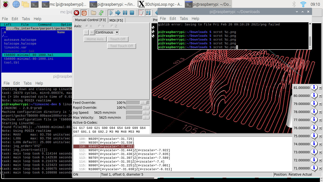

26 Feb 2021 09:16 - 26 Feb 2021 09:20 #200197
by tjtr33
Replied by tjtr33 on topic Linuxcnc on Raspberry
Damn don't ever use the quick reply here
then think 'where's the attachments?
then goto editor to find your entire post has disappeared.
Hello
I have 53.7us latency using RPi3B with
latency-histogram --base 80000 --servo 1000000
then adding 4 glxgears
then walking away until the next morning.
At 80us period, less 53.7uS max base latency,
I have 26.3uS to do all the step timing.
I use TB6600 ( with the 'upgrade Toshiba 190 chip )
and the step timings I use are
steplen 2000 stepspace 3000 dir-setup 5000 dir-hold 5000
I use double step and use reset-time of 5000
I use my own hal_pi_gpio which allows reset pins
I use a Sable 2015 machine and it has 200step/rev motors and 1.5mm pitch leadscrews
That makes for 0.0075mm step size at full step.
An 80uS base period makes for 12500 steps per second
at .0075mm/step, thats 93.75mm/second and 5.625meters/minute
Its TOO fast for my hardware
I am very happy.
