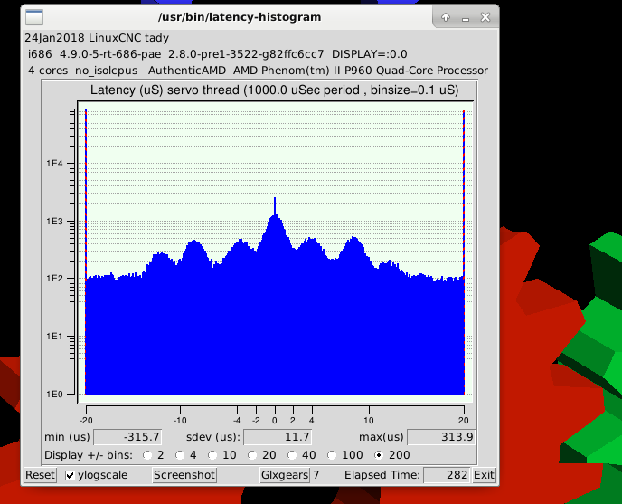

Hello
I'm running a debian 9 with RT preempt kernel on a HP pavilion db6 laptop. I have some issues with latency.
I was running latency test and I don't know if the numbers are any good.. I was fiddling with bios but this laptop doesn't have alot of settings. I was only able to turn of threading for VM.. The rest i don't know how to do..
I am a beginner in the LinuxCNC world.

What are you planning to do with it? If you are planning to use external hardware (mesa) - that is probably ok.
one thing to try is isolcpus=whatever your highest core is in the and maybe idle=poll in the kernel line... The cores start out at 0 so if you have a 4 core machine then isolcpus=3
This might have a performance hit on the system - though in my experience on newer computer hardware it isn't noticable
for testing - when the computer first boots to the grub screen - hit 'e' to edit. Look for the line that ends in 'quiet' and add isolcpus= and maybe idle=poll. then F10 to boot
sam
sam

Also if you intend to use external hardware, you do not need a base thread so you can get a better
representation of the latency by disabling the base thread:
latency-test 1ms 1ms
or
latency-histogram --nobase
or

uname -a : Linux LinuxCNC 4.9.0-5-rt-686-pae #1 SMP PREEMPT RT Debian 4.9.65-3+deb9u2 (2018-01-04) i686 GNU/Linux
the isolcpus=3 did not work .... I started latency-histogram --nobase, and on the top left corner it says "no_isolcpus" so i think it did not woork when I edited the GRUB startup.
Now i got a max jitter of 548135 ... This clearly is sh*t :/
