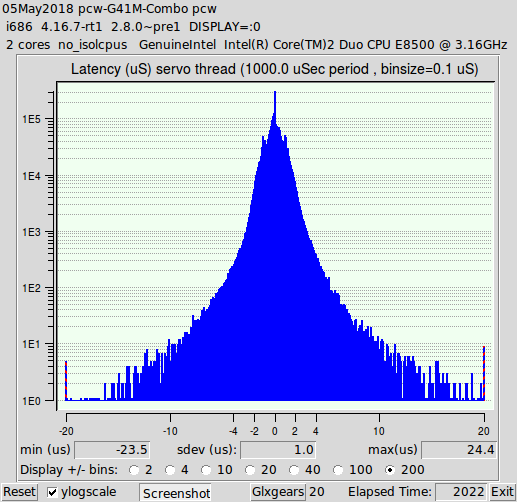

Yeah, as Todd says laptops are generally not good real time hosts because they have power management hardware/firmware than cannot be disabled and that causes very long latencies. Older machines can have decent latencies, here's a Core Duo E8500
(desktop) running a current Preempt-RT kernel while watching youtube videos, reading email etc etc:

07 May 2018 21:37 #110364
by BrendaEM
Replied by BrendaEM on topic Dell Precision Dual-Core 2.6ghz Laptop Gets 3.5 Million NS in Latency?
Is that fancy graph part of Linux CNC?

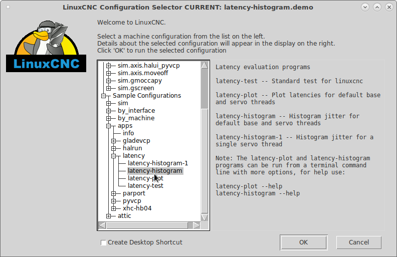

08 May 2018 08:52 #110382
Yes, its the "latency-histogram"
In the example above it was invoked with:
latency-histogram --nobase
because I did not want a base thread
You can get all the options with:
latency-histogram --help

- Todd Zuercher
- Posts: 4795
- Thank you received: 1483
08 May 2018 08:56 #110383
Replied by Todd Zuercher on topic Dell Precision Dual-Core 2.6ghz Laptop Gets 3.5 Million NS in Latency?
- BrendaEM
- Posts: 266
- Thank you received: 120
08 May 2018 23:17 #110408
by BrendaEM
Thank you Todd Zuercher : )
I would not have looked for it there.
