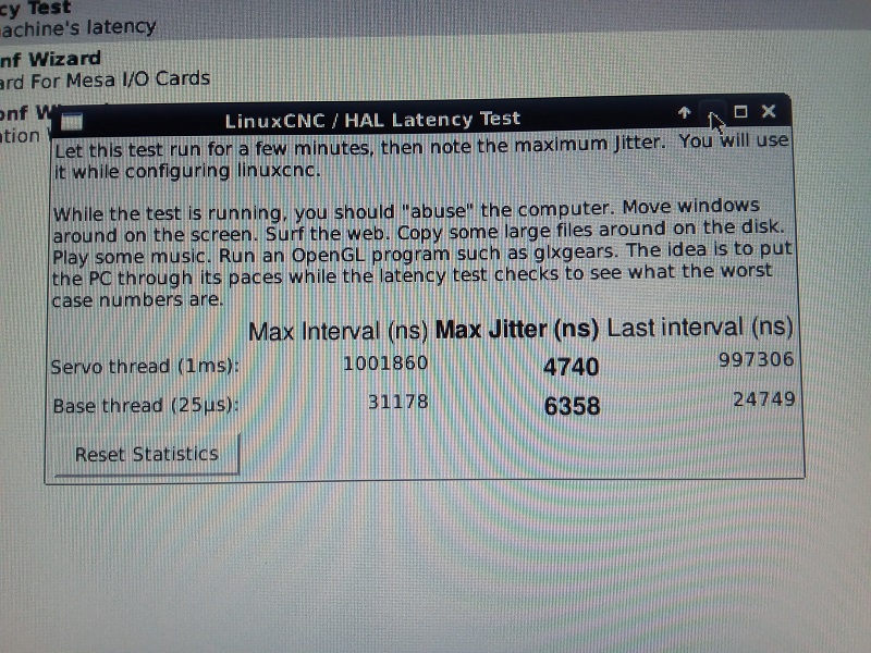

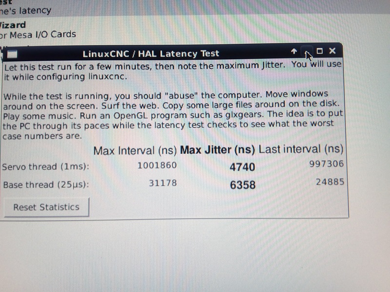

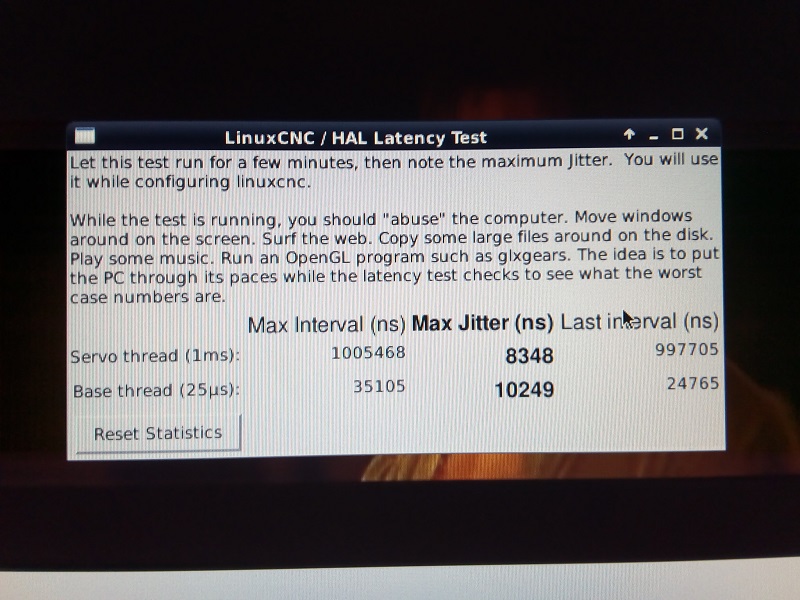

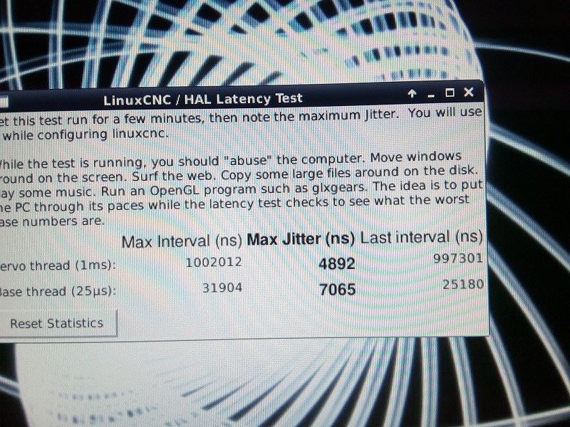

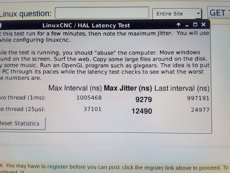

- Fermaq
- Posts: 42
06 Sep 2018 15:33 - 06 Sep 2018 15:36 #117164
by Fermaq
Replied by Fermaq on topic Old Intel E5300 2.6Ghz good enough for Mesa 7i76E?
Latency test.
The photos in the following order.
Before loading the desktop; -After loading the desktop (a video on you tube and some pages opened randomly). -And the last 2 photos after closing what had opened.
What do you advise me, the pc is good or should I think of another?
I do not open music because I do not have sound on this pc. Video that I see on you-tube is only image, (without sound)
Last edit: 06 Sep 2018 15:36 by Fermaq.
- Posts: 22049
- Thank you received: 7509
06 Sep 2018 16:25 #117168
Replied by tommylight on topic Old Intel E5300 2.6Ghz good enough for Mesa 7i76E?
All of the results in the last post are very good, so you can use it for sure.
For the 7i76E you have to use the stretch version, not the wheezy one.
