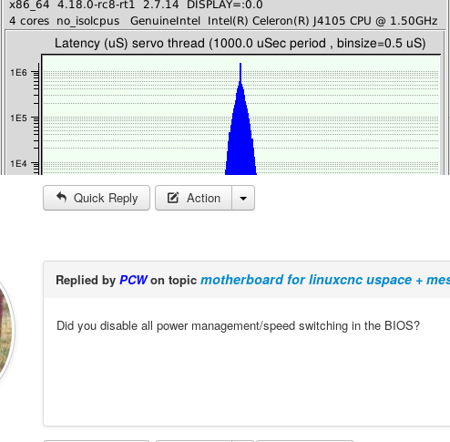

29 Aug 2018 09:21 #116772
by vre
Replied by vre on topic motherboard for linuxcnc uspace + mesa 7i80hd
here is latency-histogram --nobase --sbinsize
with 5 glxgears running and 1 youtube open

29 Aug 2018 11:22 #116783
Replied by PCW on topic motherboard for linuxcnc uspace + mesa 7i80hd
forgot to include the sbinsize, really meant
latency-histogram --nobase --sbinsize 500
80 usec is probably OK and there may be a couple things that you can do to reduce the latency:
Disable all power saving/speed switching options in the BIOS
add idle=poll in the kernel command line
Try various isolcpus settings in the kernel command line
sometimes isolcpus helps sometime not...

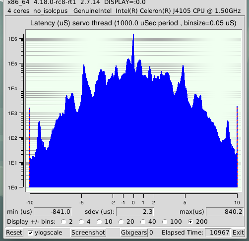

29 Aug 2018 12:26 #116796
by vre
after 2 hours the jitter is very much is unusable with this jitter
- Posts: 18122
- Thank you received: 5337
29 Aug 2018 12:34 #116799
Did you disable all power management/speed switching in the BIOS?

I have tried many things (power managment-c states-boost disable/irqbalance uninstall/isolcpus=1 and some more) but jitter after some hours of operation with 10 glxgears goes to 900us.
What to do ? Throw to the bin ?
I never had these problems with rtai kernels with rt-preemt almost all pcs that i have tried have problem.

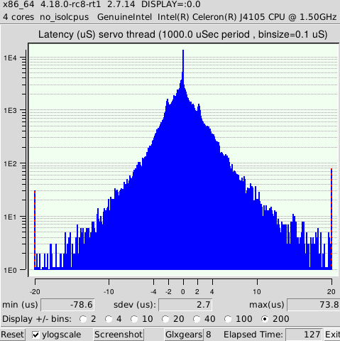

I have tested the 4.9 rt preempt that comes with stretch and the jitter
is 32us.So the new kernel 4.18 rt preempt is the problem.
But my gpu works only with 4.18...
Can you give your .config for 4.18.5 rt preempt ?

30 Aug 2018 16:32 #116890
Here's my .config file

31 Aug 2018 13:35 - 01 Sep 2018 17:47 #116924
by vre
With this config i have -94us to 94us after 12 hours of stress test.
I think problem solved.
