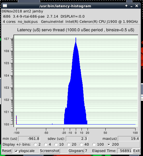

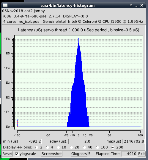

06 Nov 2018 16:04 #120122
Replied by Todd Zuercher on topic latency issues with ga-j1900n
I certainly wouldn't isolate 3 of 4 cores on a j1900. I might try 1 or 2 of them just for comparison. And it often pays to try isolating different cores or combinations of them. (The i5 i'm playing with right now gives best results with isolcpues=3.) But depending on the setup you have it may not even be worth the effort.
- jamby
- Posts: 235
- Thank you received: 6
06 Nov 2018 17:09 #120126
by jamby
Replied by jamby on topic latency issues with ga-j1900n
- Posts: 18122
- Thank you received: 5337
06 Nov 2018 17:18 #120127
Replied by PCW on topic latency issues with ga-j1900n
oops 2 ms latency on a 1 ms thread is nogo
Is it possible you have some power management option still enabled or a bad harddrive?
I dont think I've seen that bad on anything other than laptops

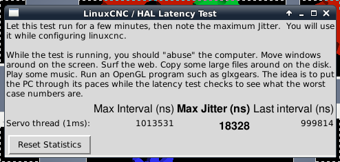

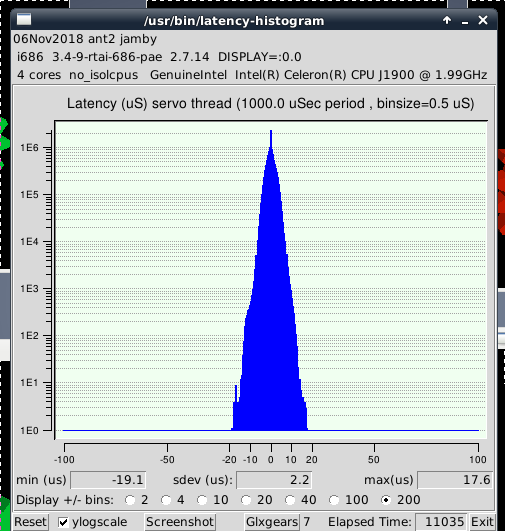

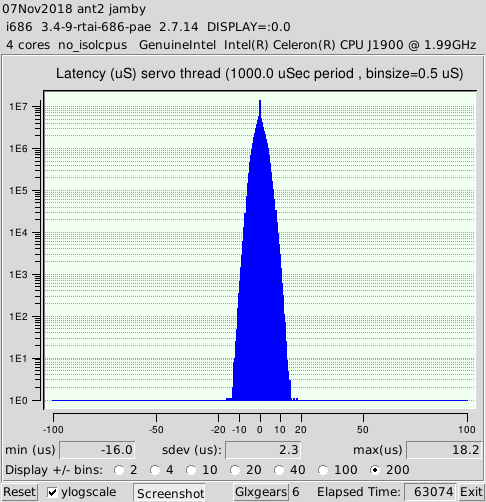

07 Nov 2018 09:50 - 07 Nov 2018 09:54 #120176
by jamby
Last edit: 07 Nov 2018 09:54 by jamby. Reason: include the pictures
- Posts: 18122
07 Nov 2018 11:40 #120188
Still nearly 1000000 ns latency
I still suspect you have a power management option (say C states >C1 enabled) enabled in the BIOS or bad hardware (bad drives can do this)
- Posts: 19914
- Thank you received: 4663
08 Nov 2018 06:04 #120250
Replied by andypugh on topic latency issues with ga-j1900n
Is there any chance this is SMI?
