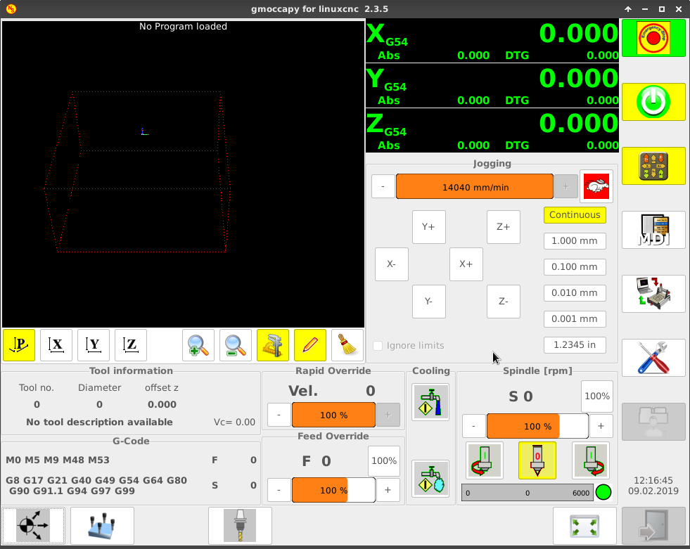

09 Feb 2019 10:27 #126040
by vre
Replied by vre on topic RockPro64
I have in my hands rockpro64 iam writing from this now.
Board is fast i have compiled linuxcnc but only sim because
i can not find preempt-rt patch for the kernel version armbian has.Is there any preempt-rt patch for kernel 4.4172 ?

09 Feb 2019 17:02 #126063
by blazini36
Replied by blazini36 on topic RockPro64
I see the same thing with my rock960 on Debian, 4.4.154.
If you can find the kernel config you should be able to compile a kernel that does have a patch and configure it with the same options. Unfortunately on my board the config files don't seem to exist in any place I've checked for them so I'm waiting to hear back from the discussion group.

09 Feb 2019 18:52 - 09 Feb 2019 18:56 #126066
by vre
i have installed armbian the problem is this
There is version mismatch between armbian kernel source code version and preemt-rt patch version
so patch fails...
I will try to search at rockchip kernel repository if there is a previous version 4.4.169
or if preempt-rt project release 4.4.172 patch
Except this serious problem the board is fast linuxcnc runs fast at simulation mode.
# ls ../preempt-rt/patch-4.4*
../preempt-rt/patch-4.4.162-rt176-rc1.patch.gz ../preempt-rt/patch-4.4.169-rt177.patch.gz
root@rockpro64:/usr/src/linux-source-4.4.172-rockchip64# make kernelversion
4.4.172
root@rockpro64:/usr/src/linux-source-4.4.172-rockchip64#There is version mismatch between armbian kernel source code version and preemt-rt patch version
so patch fails...
