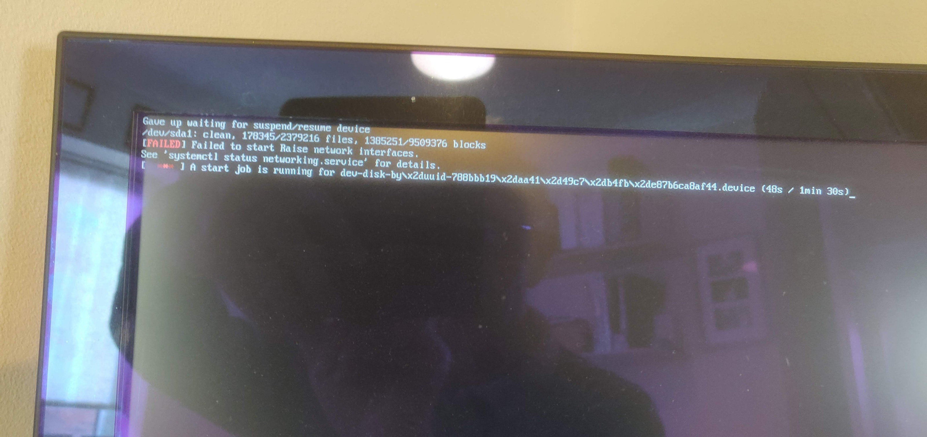

Upon have a good working system with good boot time, I have used Clonezilla to image the drive but when restoring the image back to the drive and then booting into linuxcnc it seems to indicate a problem that is taking about 1min-50secs delay to resolve before continuing with the boot. It does boot successfully and works ok.
With my little knowledge of linux I think it is the swap file that has not been imaged and restored correctly.

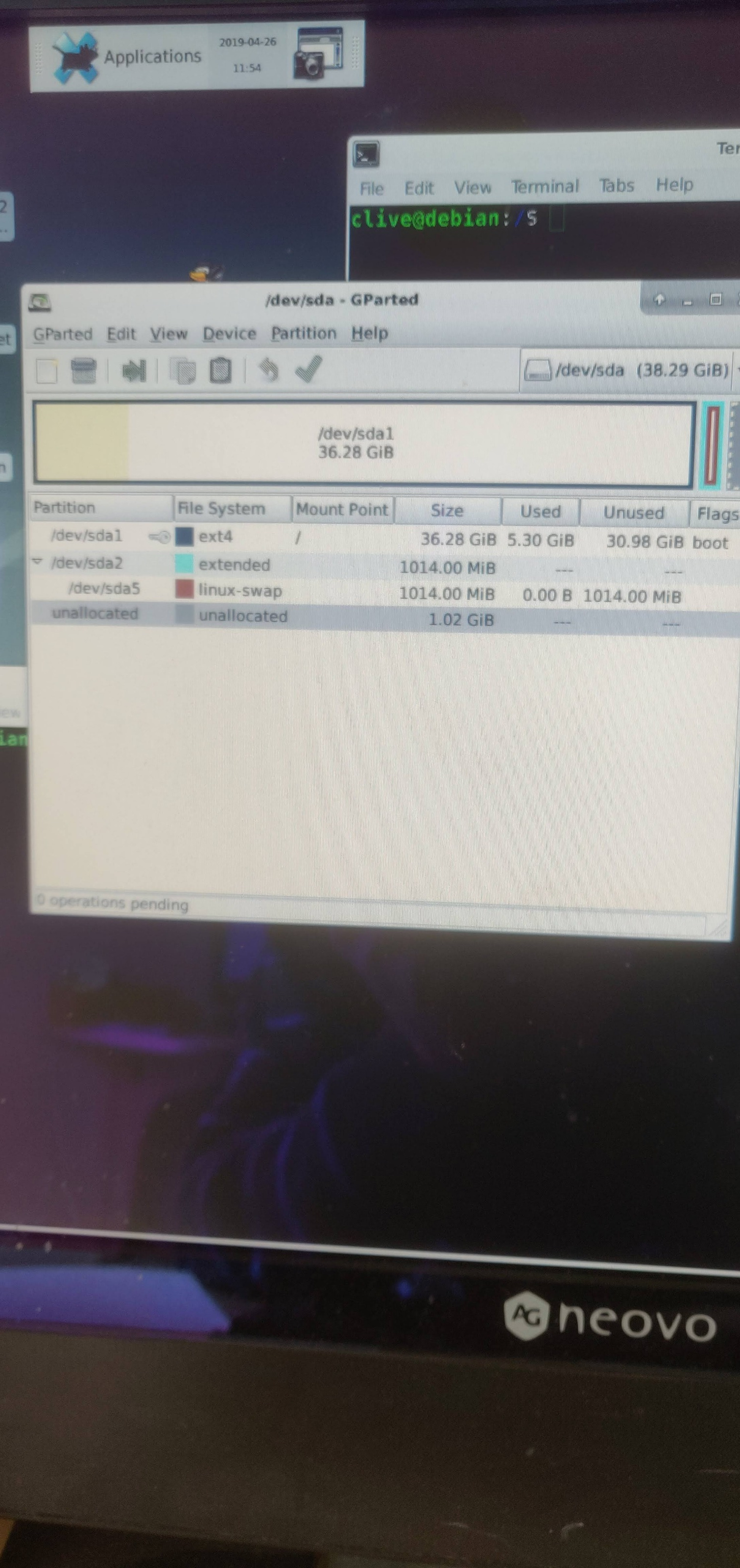

looking at the drive with Gparted I had to format the sda5 partition with linux-file system but I am at a loss at how to activate it
to get rid of the error when booting.

The problem is with the swap partition uuid.
This page is how to fix the issue, the last 2 answers are what you want, starting with "From Terminal run" both of the last 2 answers need reading and acting on.
askubuntu.com/questions/625072/deleted-s...w-boot-takes-forever
Basically put in the new UUID of the swap partition in /etc/fstab
Comment out or put in the new UUID of the swap partition in /etc/initramfs-tools/conf.d/resume
Update the initramfs with:
sudo update-initramfs -u -k all
Reboot and all should be good.

Thank you for the rapid reply. I inadvertently attached the wrong pic but have now corrected the pic.
Why a 40GB swap ?
A swap partition does not have a file system, as such on it, as on it.
Please see new pic.
Re the partition I did change the sda5 with gparted to add a file system. Was this incorrect? or is it ok.
I will attempt to do as you suggested and report back (might have to be in a couple of days)

If that is the correct picture of gparted, sda5 is correct as it is.
if you run (the switch/letter is a lowercase L)
fdisk -l /dev/sda
and you get a line such as this for sda5 (the example below is a snippet from my desktop)
/dev/sda5       1024292864 1039550463  15257600   7.3G 82 Linux swap / Solaris
What you are interested in is the last 2 columns where:
Id should be 82
Type should be Linux swap / Solaris
To make sure everything is ok, before modifying the 2 files, you can use
sudo swapon /dev/sda5
To check the status if you want to confirm that things are ok after using the above or after modifying the files mentioned and rebotooing you can use
swapon --show
Hopefully that should see you right. Always happy to help when I can.
