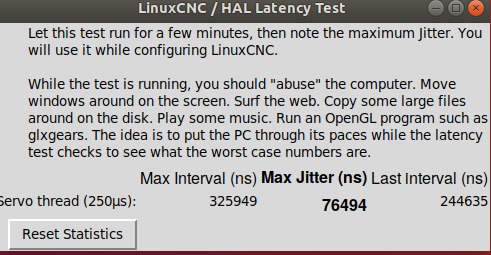

Latency Control Request for rt_preempt
- bkt
- Posts: 1111
- Thank you received: 114
10 May 2019 12:39 - 10 May 2019 12:41 #133387
by bkt
Latency Control Request for rt_preempt was created by bkt
Last edit: 10 May 2019 12:41 by bkt. Reason: add text

Hi
its 80k
so no problem
leve the 100k that stepconf gets Automated into
if you see RT error or following error
incres in in BASE_period to 120k or even 150k
NO problem
IF you are on Ethernet with mesa its not a factor
its 80k
so no problem
NO problem

Replied by bkt on topic Latency Control Request for rt_preempt
no error from 2 days ,,, so is good enought
regards
