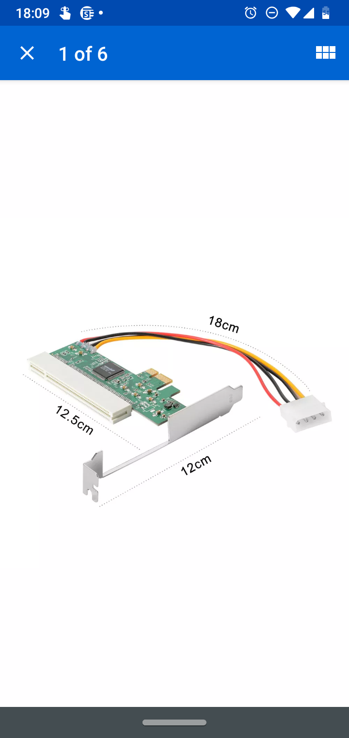

Building a 2nd pc as back up.
Sourced a similar machine but it doesn't have a PCI slot, so my 5i25 won't fit. Instead it's all pci-e slots
Can I use an adaptor, ? See image attached, looks like a simple and cheap solution.

At the end of this thread
forum.linuxcnc.org/18-computer/36627-pci...-and-linuxcnc#134491
is a link to one that is known to work.
