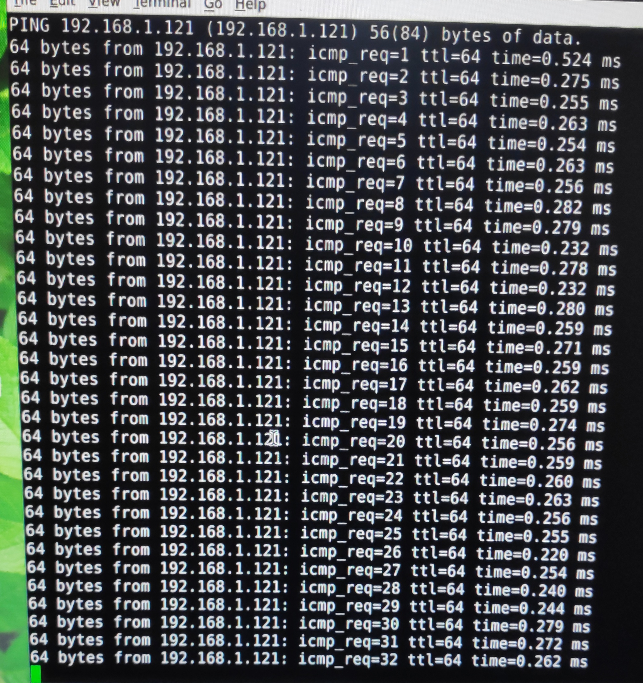

This is ping result before doing anything
Then I added the following line to interfaces file:
Then got this ping results
It's almost the same result
Is 0.3 ms a good time for ping result or not?

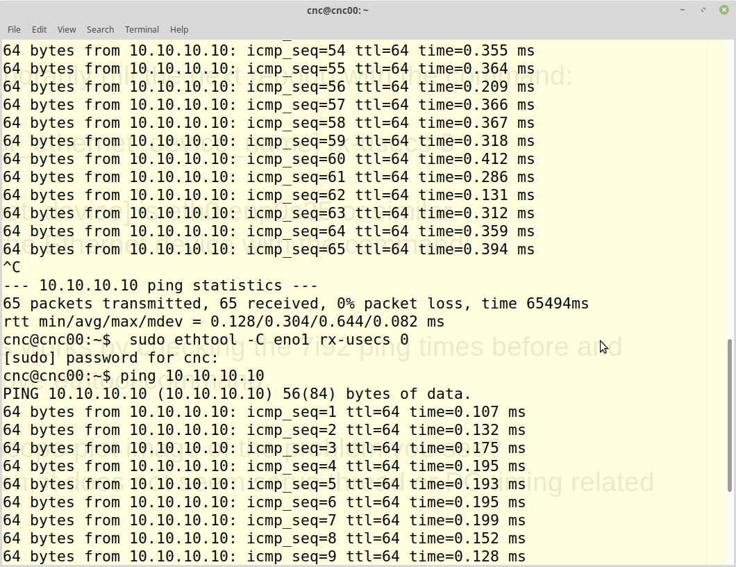

OK so you have a intel MAC, this means you will need to disable a Ethernet driver feature called "IRQ coalescing" if you have not already. This is described in hm2_eth man page
You can do this temporarily (till the next reboot) with the command:
sudo ethtool -C [your_ethernet_device_name] rx-usecs 0
Where [your_ethernet_device] is eth0,enp0s25 or similar
You can determine the Ethernet device with the command:
ip a
You can check if this works by checking the 7i92 ping times before and
after you run the above ethtool command
Can you post a halscope plot image of the problem you see?
From your description, it does not seem servo thread or PC timing related
hardware−irq−coalesce−rx−usecs 0

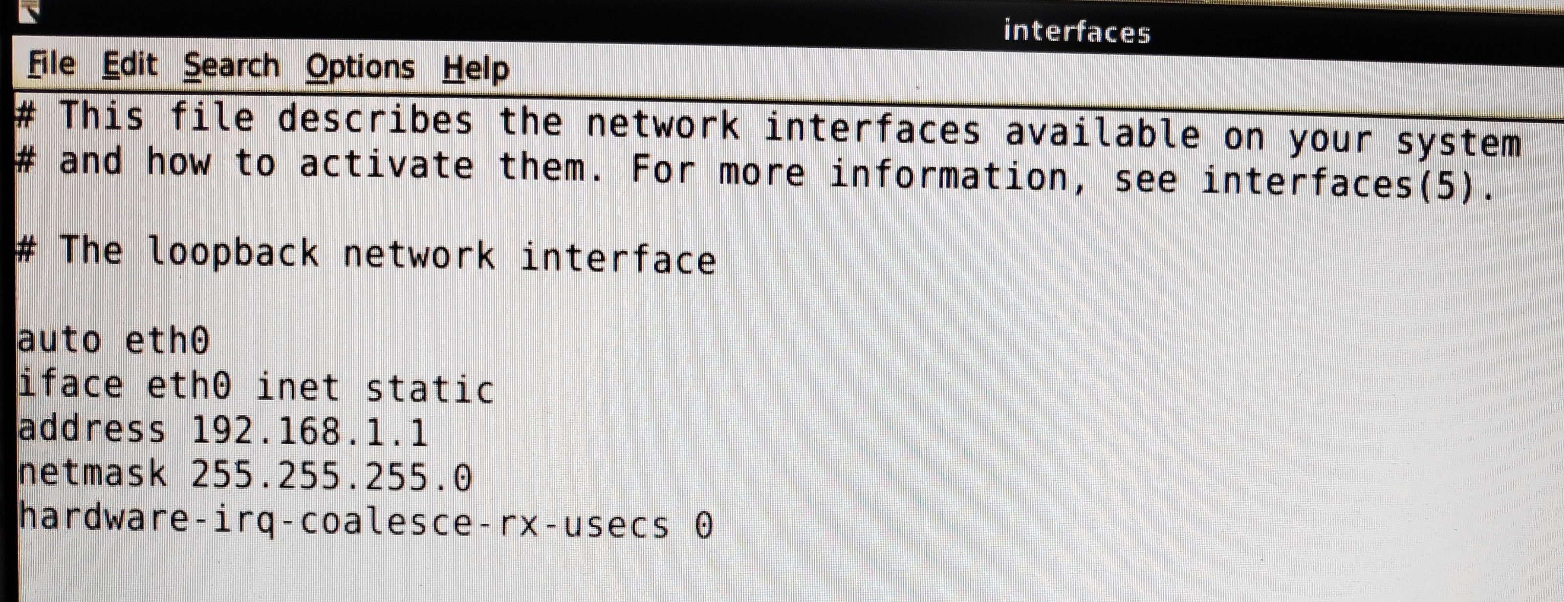

- AElmasry
- Posts: 25
29 Jun 2019 17:54 #138210
by AElmasry
This is how interfaces file looks like now
Do you think the other lines you added can make a diffrence?
Replied by AElmasry on topic Help selecting new PC to run Mesa 7I92 Ethernet
you can also do this in the interfaces
sudo gedit /etc/network/interfaces
#7i92 2019
auto eth0
iface eth0 inet static
address 192.168.1.4
netmask 255.255.255.0
network 192.168.1.0
broadcast 192.168.1.255
gateway 192.168.1.1
dns-nameservers 8.8.8.8 4.4.4.4
hardware-irq-coalesce-rx-usecs 0
then
sudo /etc/init.d/networking restart
if it fails
sudo /etc/init.d/networking stop
sudo /etc/init.d/networking start
ofcause as you got the 7i92 jumperd
if yoiu use other networking adresses just correct it

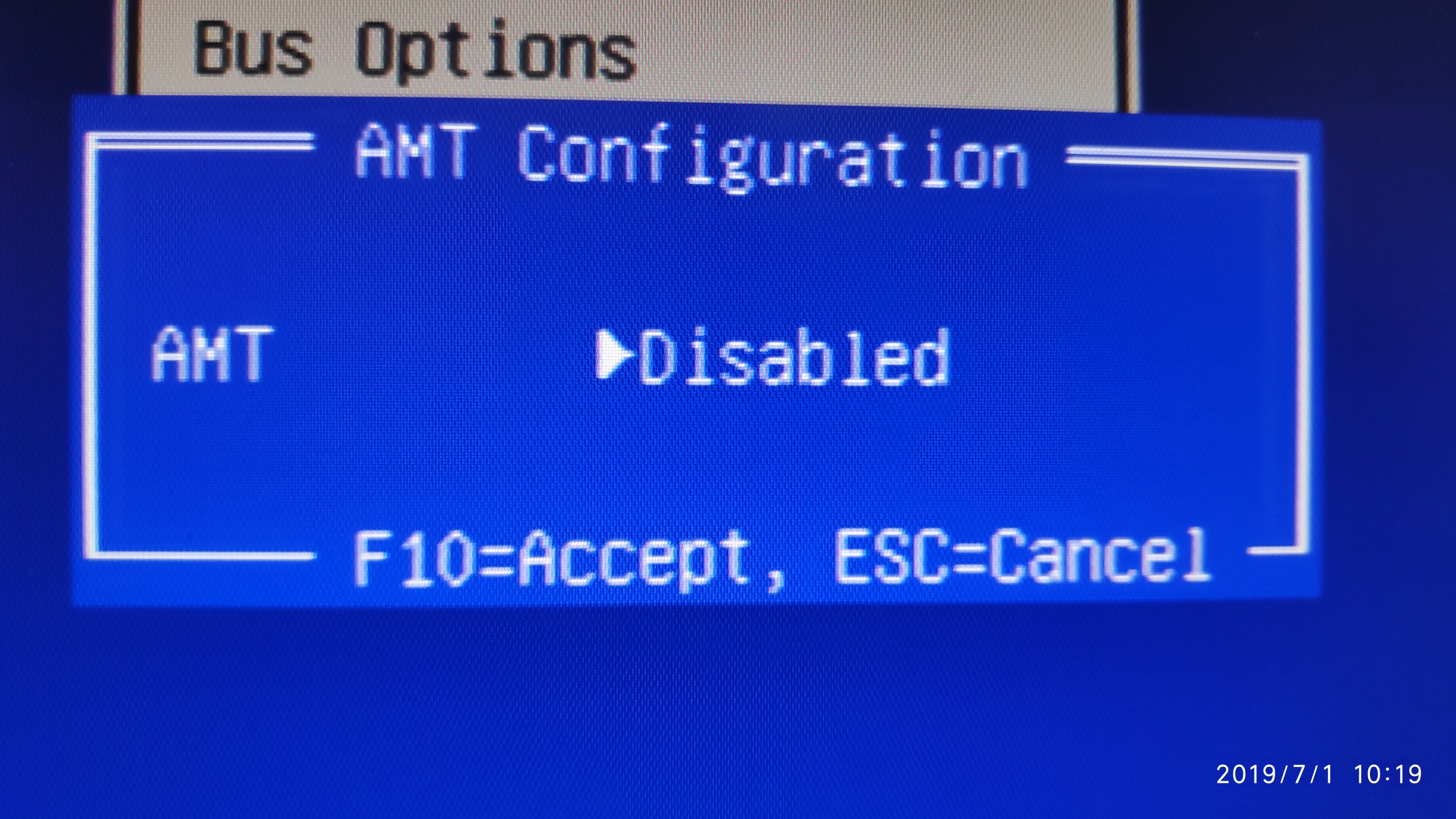

Well, that's fairly terrible latency (I see a 370 usec there and there may be worse)
Do you have all power management turned off?
If Intel AMT is an option in the BIOS, it should be turned off also

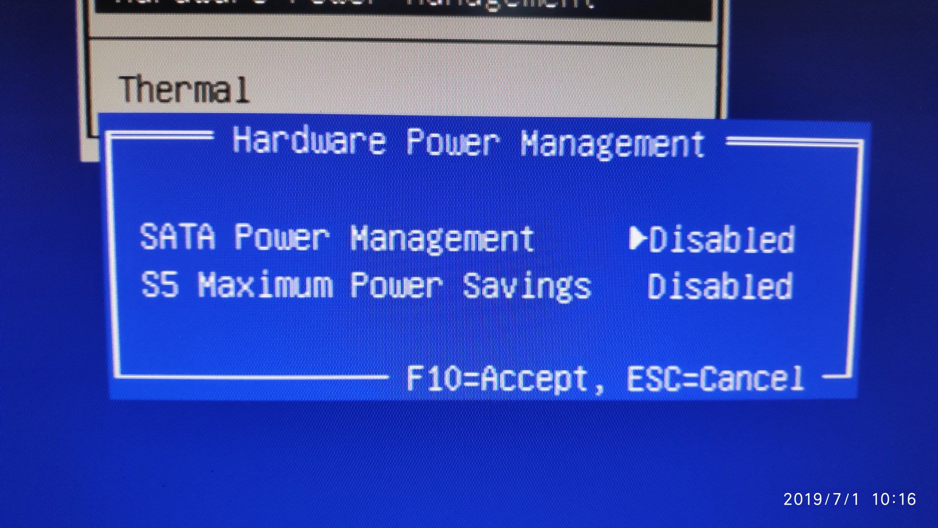

01 Jul 2019 10:51 #138305
by AElmasry

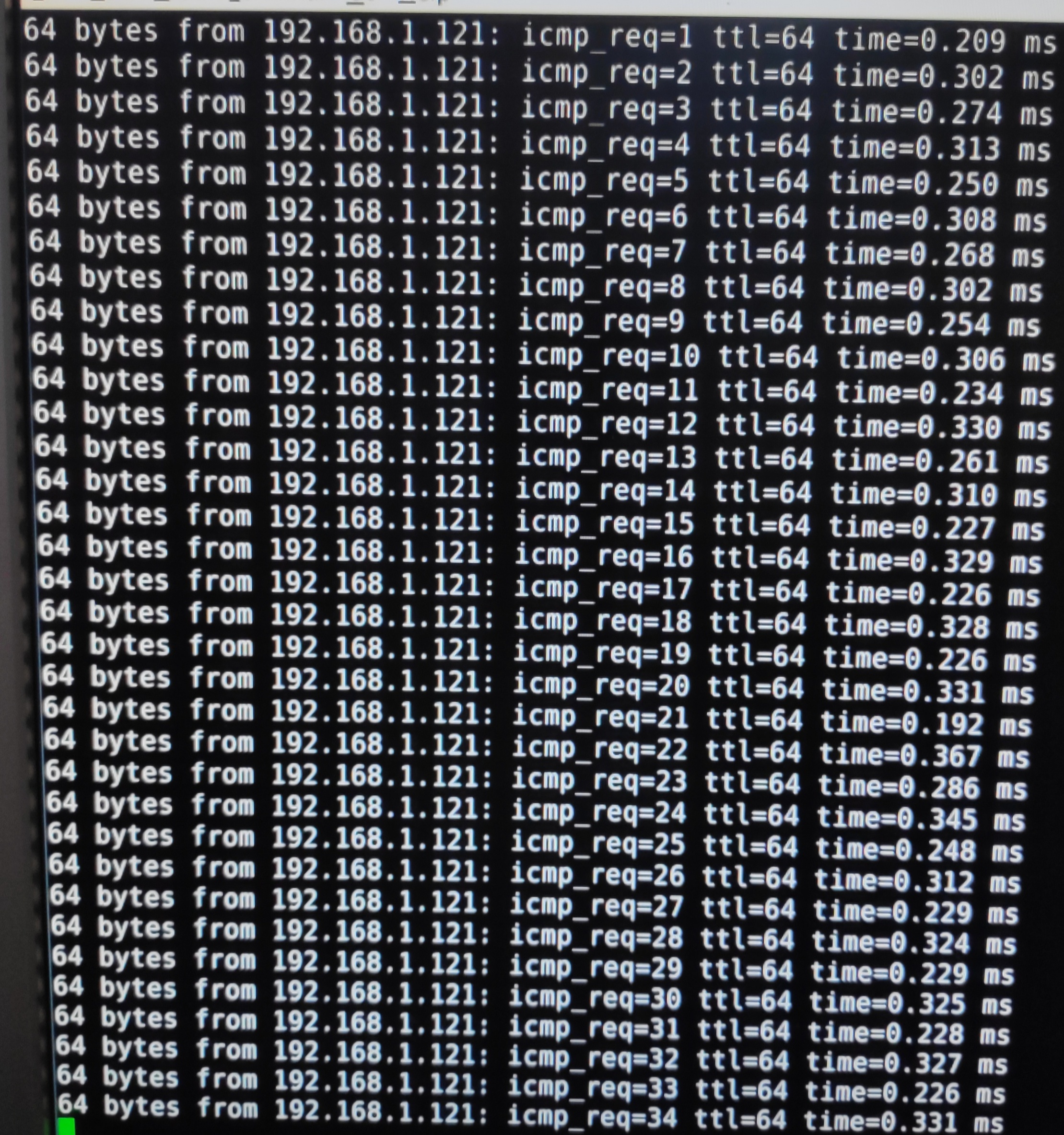

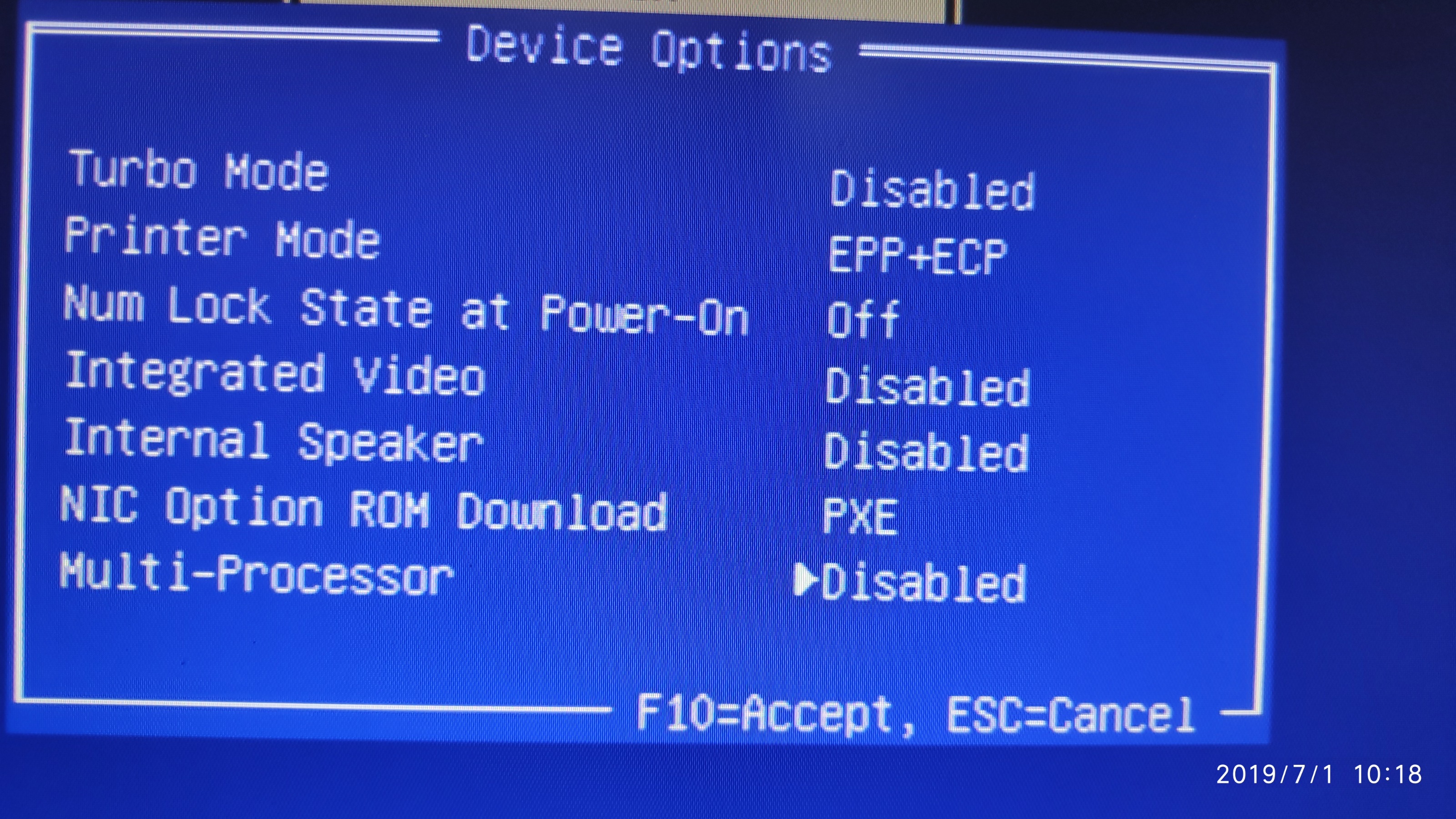

I diabled all power management and AMT
and got a little bit lower timing
I tried also to disable multiprocessor but got the same results

- Posts: 18122
- Thank you received: 5337
01 Jul 2019 10:56 #138306
Replied by PCW on topic Help selecting new PC to run Mesa 7I92 Ethernet

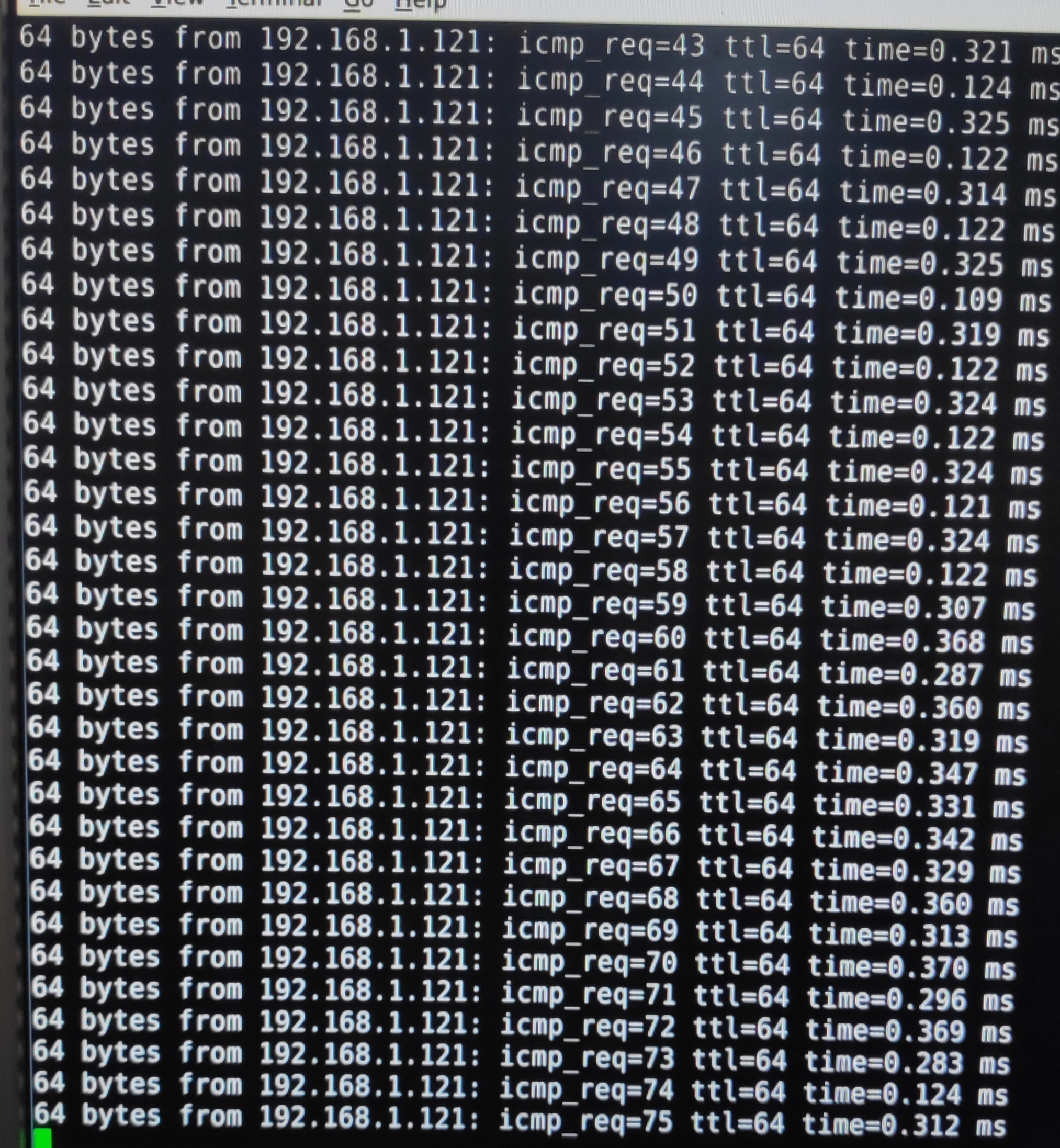

I would not disable multi-processor
Did you try disabling irq coalescing from the command line as tommylight showed above?
(just to make sure its really disabled for your test)
