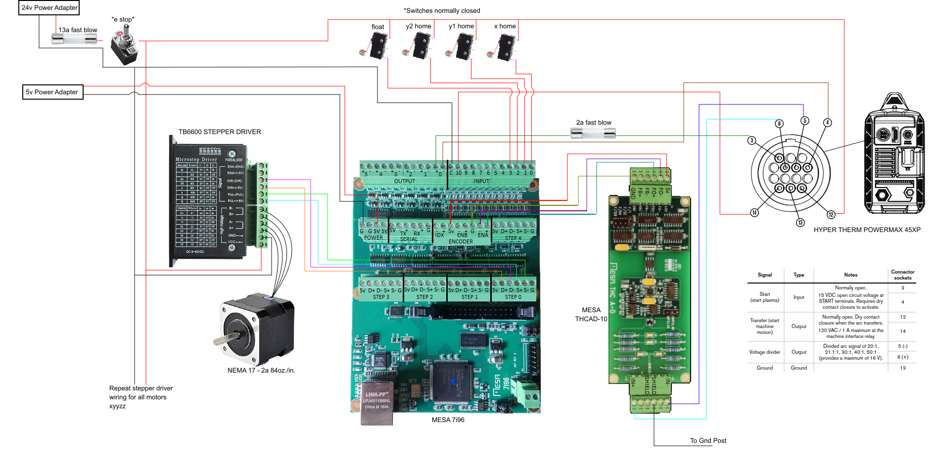

Hello,
I am knew to Linux and this forums so if I posted this in the wrong section my apologies
My Questions:
Does latency numbers matter when using a mesa, Ethernet connected, board?
Based on my pc should I stick with Debian 9 or should I used a different Linux OS
I’m building a 4x4 cnc plasma table to be used for hobbies and a light side “hustle” hopefully. I have it fabed up and ready to start testing. Its A XYY’Z dual motor gantry set up. I plan on using a candcnc’s Feather Touch Ohmic Sensor as well. I search the Forums and found a picture of someone else wiring setup that coincidently is the same outline I was going to used.
I intend to use the Proma’s linuxcnc plasma as a base configuration

Latency matters only if it is uterly useless for mesa, your board should be good so no worries.
If you have a THCAD do not buy a proma, those are the same thing in different versions.

If you adopt the master branch V2.9 there is a complete plasma controller called Plasmac. It may end up in V 2.8 but it won't have the reverse run feature for error recovery that is in V 2.9.
If you follow your nose to the 2.9 Docs from the home page, you will find a link to the plasmac user guide under the heading "User Interfaces"
linuxcnc.org/docs/devel/html/plasma/plasmac-user-guide.html.
Also in the V 2.9 docs, under "General User Information", there is a link to a Plasma cutting primer which you must read.
linuxcnc.org/docs/devel/html/plasma/plasma-cnc-primer.html
In relation to Ohmic sensing, I would not use the feather touch but instead adopt the proven simple Circuit in the primer which is fully supported by Plasmac and just needs an isolated power supply. 3 relays and a diode.
And yes the J1900 should be fine. Thats what I use. Just disable all power saving in the Bios and if its like my Gigabyte Brix, use a normal USB wifi dongle instead of the internal Wifi board which created huge latency.
Good luck on your journey. By the time you follow those links which have only just been added to 2.9, you will be 3 years ahead of where I started!
EDIT: And yes, the THCAD will trump the proma every time so go with it if you don't already have the proma. (Plasmac supports both) but can do more if it has the THCAD.

- pl7i92
- Posts: 1872
- Thank you received: 359
06 Jul 2019 11:07 #138746
by pl7i92
Replied by pl7i92 on topic PC OS question 4x4 table
the mashine will be the hell of speed and a very good EMI shield
you will be impressed on the performence
and phil/rod Plasmac is a very good start on the mashine setup gui for you
as rod pointed there is alredy a plasmac basic config for your mashine
you shoudt go with this wirer setup also to not be confused and get even more help
