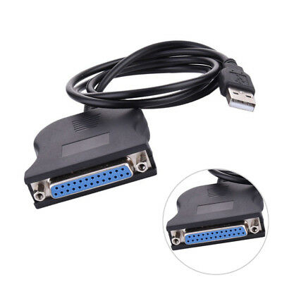

I am currently install linux cnc to
Pentium 4 D processor 1Gb ram 128 onboard VGA included desktop pc.
What is the highest base thread value to perform threading precisely.
I don't have a onboard parallel port so i planned to use 25 Pin IEEE 1284 Parallel Port D-Sub Connector to USB 2.0 Printer Adapter Cable.
Is it recommended to run linux cnc with this cable?

Replied by tommylight on topic IS my pc specifications recommended?
Already replied on the other thread, but here it is again:
P4D can be very good for latency with the intel chipset so you can easily get 50000 base thread. You need to disable hyperthreading in BIOS. Use the RTAI kernel.
Check if the motherboard has a parallel port header, almost all P4 have it, so you would need just a cable with a DB25 connector.
The USB to DB25 adapter will not work with Linuxcnc.

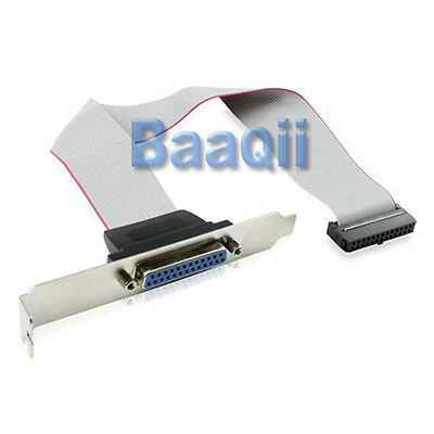

17 Jul 2019 08:54 #139693
by Dinuka_Shehan
Replied by Dinuka_Shehan on topic IS my pc specifications recommended?
my mboard specification list
www.biostar.com.tw/app/en/mb/introductio...ID=500#specification
This motherboard can connect a LPT1 Parallel Port Printer I O Adapter DB25 to IDC 26Pin Header Slot Plate Panel and after that can I use this
with latest linux cnc version?
www.ebay.com/itm/LPT1-Parallel-Port-Prin...-Panel-/122164796384
- Posts: 22049
- Thank you received: 7509
17 Jul 2019 10:21 #139702
Yes, that is the cable you need, that will work.

18 Jul 2019 03:52 #139767
by Dinuka_Shehan
Cheers.
I ordered a cable on ebay.
waiting for a it!
waiting for a it!
