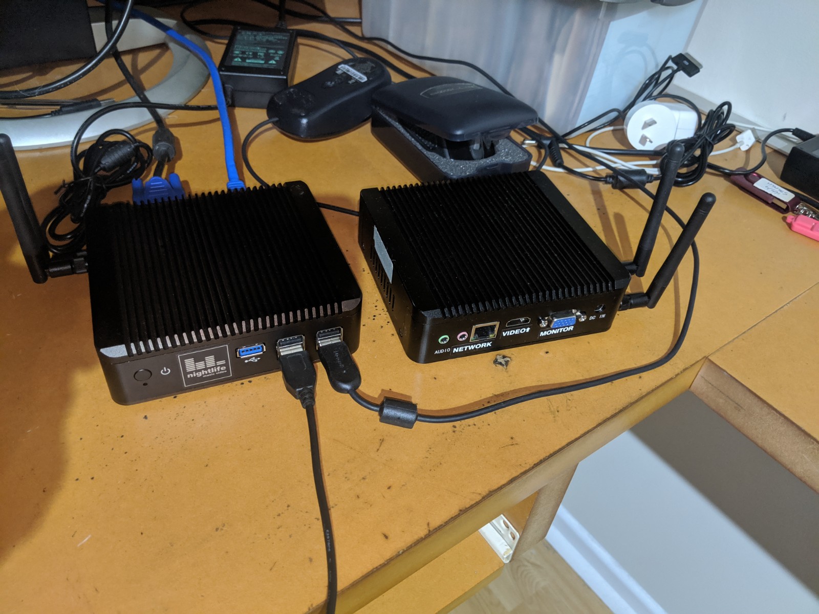

Clive, if you have latency issues let me know and I'll take some pics of the BIOS settings I am using. Need to be set to C1 from memory. Look for that anyway. So long ago.
These are a couple of J1850's another Linuxcnc user found for me. Used with 4 Gb RAM for AUD $70 each
They have a Baytrail Chip which is very problematic with Linux. I could not get them to boot until he shared BIOS settings and then one of them needed the battery removing first. With Stretch, the latency now is quite good and the inbuilt wifi works fine. I tried compiling the PREMPT_RT kernel on Linux Mint based on BigJohn's instructions and it won't boot. I did see somewhere that there might be another compiler flag that should have been set.
I've seen these on Aliexpress so it would be nice to try a J1900 version to see if the wifi is still good!

Update
The Gigabyte Brix BXBT-1900 Barebone Mini PC Kit, Intel Celeron Quad Core, DDR3L, HDMI/VGA, WiFi/BT, 2.5" SATA II, VESAversion .
I could not get it to run Linux. I have even tested it with a known good ssd with linuxcnc 2.7 on, that will boot up fine on several other PC's I have.
Looking at the Brix website it seems to only do Windows www.gigabyte.com/uk/Mini-PcBarebone/GB-B...rt#support-dl-driver

Ok. Update: I take it all back the setting to change was CSM in the bios
and disable secure boot
Thanks to all that helped.
