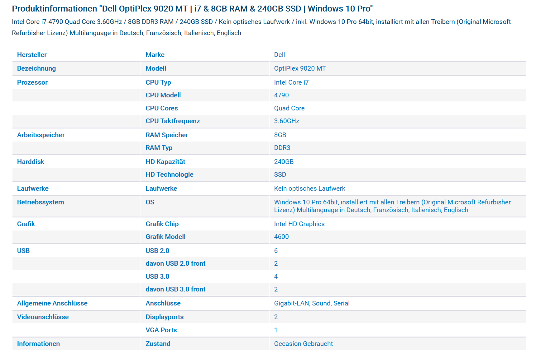

19 Feb 2020 08:02 #157856
by piter
Replied by piter on topic Recommended PC configuration: CPU and Motherboard (Q1 2020)
It's always surprising how many things one can find with the right research string..
Found an optiplex 9020 (see attached image) for a very reasonable price!
I am not sure I can post here links to resellers (?), but in case someone is interested in knowing where to source used PCs of the "families" we are talking about (in Switzerland), you can send me a pm.
Tommy: thanks for the link, just started reading it and looks like a very good reference.
Talking about the form factor, what is the "usual" approach? I would be tempted to get the largest motherboard for spare PCI ports that might come in handy along the way (I am developing a testing setup and, in my situation, the full requirements are not known beforehand but rather unfold over time), and yet I see most of the people trying to get their hands on the tiniest USFF..
Am I misunderstanding something?

Replied by tommylight on topic Recommended PC configuration: CPU and Motherboard (Q1 2020)
Oh, i had one of those, it is bloody fast with Linux Mint, it came with an Adata PRO series SSD, it was fast as hell.
Damn, that is the only PC i regret not keeping, as i can not find them anymore here. Works perfectly with Preempt-RT and is in use controlling a 2.5X1.5M router through a Mesa 7i76E. Over 2 years now, not a single hiccup!
What was the price ?
Yes it was SSF, and i like SSF's as i can just tuck them inside the control cabinet.

About 300 USD. They have 2 available, if you want...
