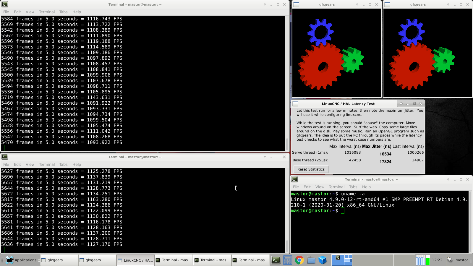

Hello. Most of the topic are asking about hardware so here it is a good PC:
Motherboard:
MSI H310M PRO VDH
8Gb RAM
SSD
Intel(R) Pentium(R) Gold G5600 CPU @ 3.90GHz
Can run linuxcnc and a windows virtual machine.
Solid and functional

Very nice latency, thank you.
