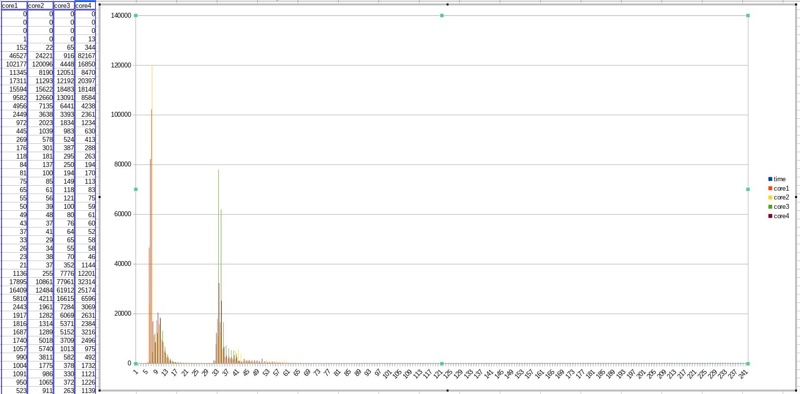

Howdy,
I am working on getting a local build going (so far so good--ish) Everything builds, all 230 tests pass.. However when I run the latency test I keep seeing "Using POSIX non-realtime" despite having an RT kernel..
here are the details on the setup:
OS: lubuntu 19.10Processor: J3455
Machine: AWOW mini PC with 6gb memory and 128gb SSD (www.amazon.com/Computer-AWOW-AK34-Ethern...d=1589680391&sr=8-18)
I have attached a histogram from running rt-tests package cyclictest... I am no expert but that seems to be showing some pretty real-time type latency (to be fare I am a touch confused about the second peak... but way better than the 1,000,000 + I get from the latency-test running in POSIX non-realtime
Any help would be great, thanks all!
OS: lubuntu 19.10
uname -a
Linux cnc-pc 5.6.10-rt5 #1 SMP PREEMPT_RT Sat May 16 14:17:03 CDT 2020 x86_64 x86_64 x86_64 GNU/LinuxMachine: AWOW mini PC with 6gb memory and 128gb SSD (www.amazon.com/Computer-AWOW-AK34-Ethern...d=1589680391&sr=8-18)
