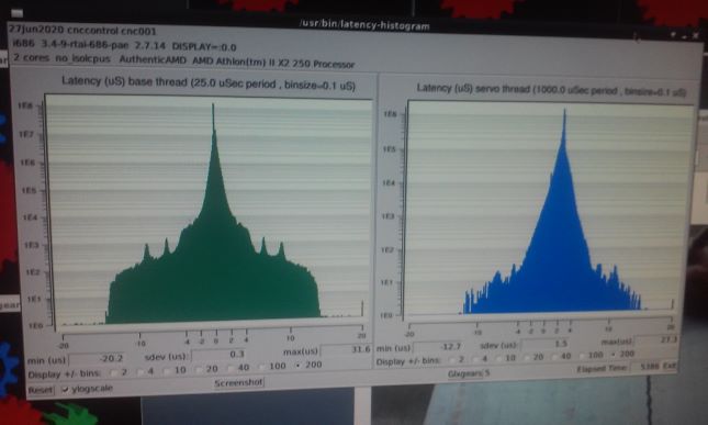

- my1987toyota
- Posts: 1004
- Thank you received: 449
27 Jun 2020 18:58 - 27 Jun 2020 19:03 #172931
by my1987toyota
Replied by my1987toyota on topic Computers to avoid list
seuchato I tried running the script on my computer ( Linuxcnc Debian wheezy 2.7.14) and coudn't get it to run. Deffinetly got to be my lack of expertise. So I think I did the next best thing I ran 5 of the glxgears programs, ran the histogram, occasionaly moving and resizing files and ran a playlist from my YouTube channel . I am not going to post it in the other section because I haven't gotten it to work for me yet.
here are the histogram results base 31.6 servo 27.3
