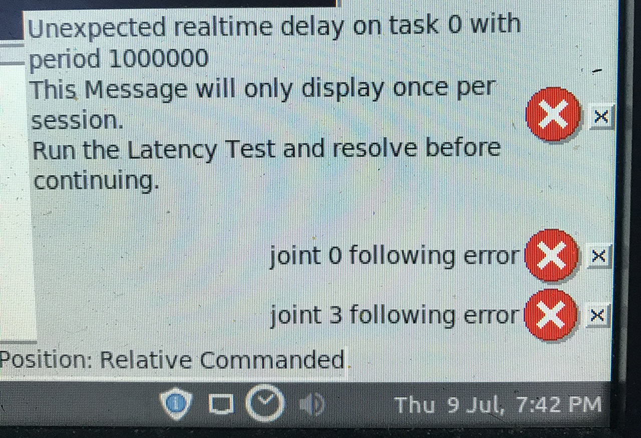

So I had no issues jogging and Homing the machine during the setup all month. Now about 5 minutes into a test run (air cutting) my spoil board I get a "Unexpected realtime delay" error.

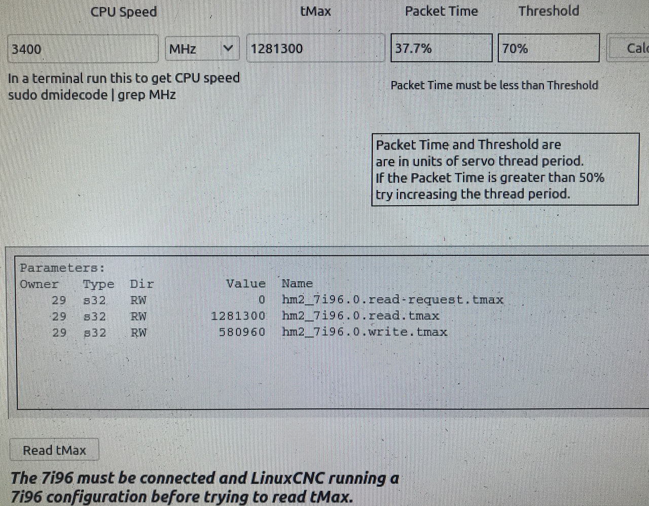

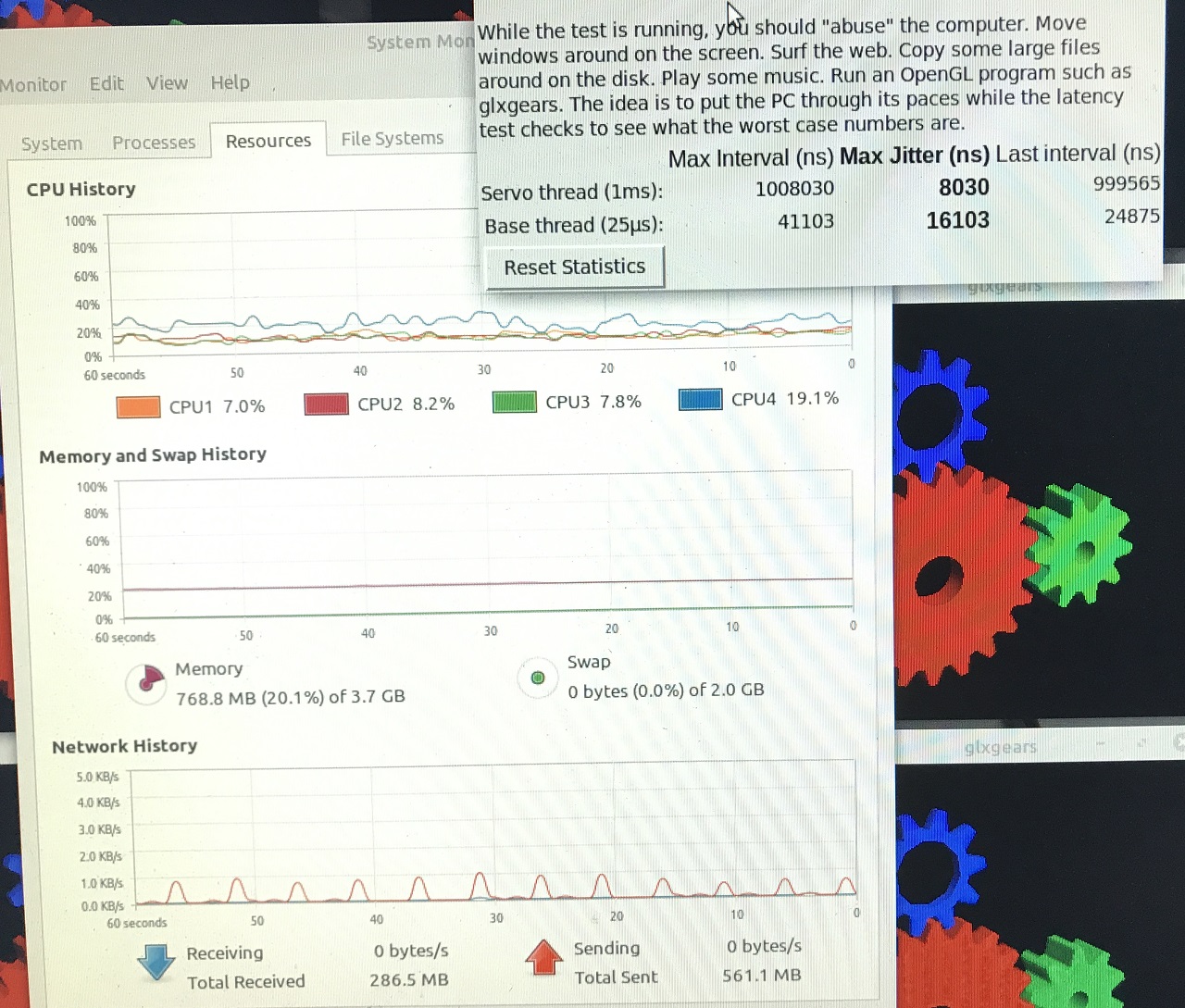

So I ran the latency test with 12 GLX gears, copied files and ran system monitor. attached are the results.
Now this is a hobby machine with relatively slow drives So I don't need extreme performance. Should I try a longer servo period? How long would be two long? Any other tips what to look at? Where would I adjust the servo/thread period?

You can try 2 ms, unless you have very high acceleration you
should not notice any difference
Also if you have a Intel MAC on the host PC you need to disable
IRQ coalescing as described in the hm2_eth manual page.

I changed the coin battery in the PC so I probably need to check the BIOS that virtualization is off correct? Any other settings to disable in BIOS?

I would disable any speed switching or power saving modes
(EIST, Turbo mode, C1 states above C1 etc)

Also hyperthreading, speed step....
