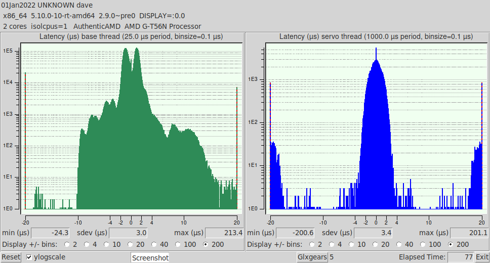

01 Jan 2022 20:23 - 01 Jan 2022 20:27 #230476
by davidimurray
Replied by davidimurray on topic Installing LinuxCNC On HP T610 Thin Client
Hi All
Sorry for the late reply, removed the wifi card from the PC and it then refused to boot so I had to do a fresh install.
Bit confused why the report was only showing 2GB of ram in it. The BIOS is showing 4GB and so does linux. I;ve re-run the script now and latency is no better - see report below.
I also ran the latency test and latency-histogram (results attached) with similar results.
Is there something I am missing?
LinuxCNC pc tests, version 20200930, started 01.01.2022 19:13:41
General info:
Hewlett-Packard, HP t610 WW Thin Client
Bios version K30 v01.20, dated 03/10/2015
Chipset: Harddisk is non-rotational, ie. SSD
The amount of swap currently used is 0
CPU related data:
model name : AMD G-T56N Processor
cpu cores : 2
stepping : 0
cache size : 512 KB
RAM related data:
Maximum Capacity: 8 GB
GPU related data:
product: Wrestler [Radeon HD 6320]
configuration: driver=radeon latency=0
Parallel port related data:
number of parallel ports is 1
parport0: PC-style at 0x378 (0x778), irq 7 [PCSPP,TRISTATE,EPP]
Os and desktop related data:
PRETTY_NAME="Debian GNU/Linux 11 (bullseye)"
Should the info below not match with your machine,
kindly post the output of pstree here, including a brief
desciption of your desktop environment, window manager and
display manager. Tia
https://forum.linuxcnc.org/18-computer/39370-script-for-automated-testing-of-computer-latency
Desktop environment : gnome
Windowmanager : Metacity (Marco)
Displaymanager : lightdm
Kernel related data:
Kernel 5.10.0-10-rt-amd64
GRUB_CMDLINE_LINUX_DEFAULT="quiet isolcpus=1"
Cpu idle driver: acpi_idle
Kernel modules data:
Check if pcspkr is loaded: [0;31mYes, may cause bigger latency.[0m
can be eliminated using:
sudo echo "install pcspkr /bin/true" >/etc/modprobe.d/pcspkr.conf
Check if snd modules are loaded: [0;31mYes, may cause bigger latency.[0m
can probably be disabled in bios, alternatively, you can run
"./block-snd-modules"
which has just now been created for your convenience.
Keyboard & Mouse related data:
Number of mice: 1
Mouse 0 : Telink Wireless Receiver Mouse
Mice attached to USB:
Keyboards attached to USB:
Dell Computer Corp. Keyboard SK-8115
LinuxCNC related data:
LinuxCNC version is: 2.9.0~pre0
Preparing for latency test:
Started glxgears No. 1, 2, 3, 4, 5
Started firefox with 'https://vimeo.com/150574260', WID
Command for latency test is:
su dave -c "latency-histogram --nobase --sbinsize 1000 --nox 2>&1 | tee -a 1641064327.lat &"
Latency testing loop started Sat 1 Jan 19:14:14 GMT 2022,
should end after Sat 1 Jan 19:27:34 GMT 2022
Manual termination requested at 01.01.2022 19:16:26
Swap useage: prerun: 0, running: 0
CPU core temperatures:
Note: Using POSIX realtime

119 s servo min:-180.100 us max: 180.800 us sdev: 1.700 us
121 s servo min:-180.100 us max: 180.800 us sdev: 1.700 us
122 s servo min:-180.100 us max: 180.800 us sdev: 1.700 us
123 s servo min:-180.100 us max: 180.800 us sdev: 1.700 us
124 s servo min:-180.100 us max: 180.800 us sdev: 1.700 us
125 s servo min:-180.100 us max: 180.800 us sdev: 1.700 us
126 s servo min:-180.100 us max: 180.800 us sdev: 1.700 us
127 s servo min:-180.100 us max: 180.800 us sdev: 1.700 us
128 s servo min:-181.200 us max: 180.800 us sdev: 1.700 us
129 s servo min:-181.200 us max: 180.800 us sdev: 1.700 us
131 s servo min:-181.200 us max: 180.800 us sdev: 1.700 us
132 s servo min:-181.200 us max: 180.800 us sdev: 1.700 us
133 s servo min:-181.200 us max: 180.800 us sdev: 1.700 usAttachments:
Last edit: 01 Jan 2022 20:27 by davidimurray. Reason: attachment missing
- ALittleOffTheRails
- Visitor
01 Jan 2022 20:53 #230483
by ALittleOffTheRails
Replied by ALittleOffTheRails on topic Installing LinuxCNC On HP T610 Thin Client
First off no need for a base thread if you are going to use Ethernet.
Second a couple of posts up I gave a link that explains “the missing ram” mystery. Also what to do to mitigate it.
- davidimurray
- Posts: 78
- Thank you received: 5
01 Jan 2022 21:06 #230484
by davidimurray
Hi
I am not selecting the base thread when running the test. Currently seeing over 200 which i understand is likely to cause issues with an ethernet setup.
I've followed Joco's BIOS settings and the graphics card is forced to 64m - this has made no improvement to it being in auto.
Seems strange my results are so poor compared to Joco's
- Visitor
01 Jan 2022 23:04 #230494
There are quite a few differences in setups.
For instance the kernels are different, OS are different, WIndow managers & Desktop environments are different, even the kernel command lines are different.
Actually the differences are so much so that it is no wonder there are differences in latency figures. You are not really comparing apples with apples. There is nothing really strange about it.
The latency histogram clearly shows you are running a base thread.
