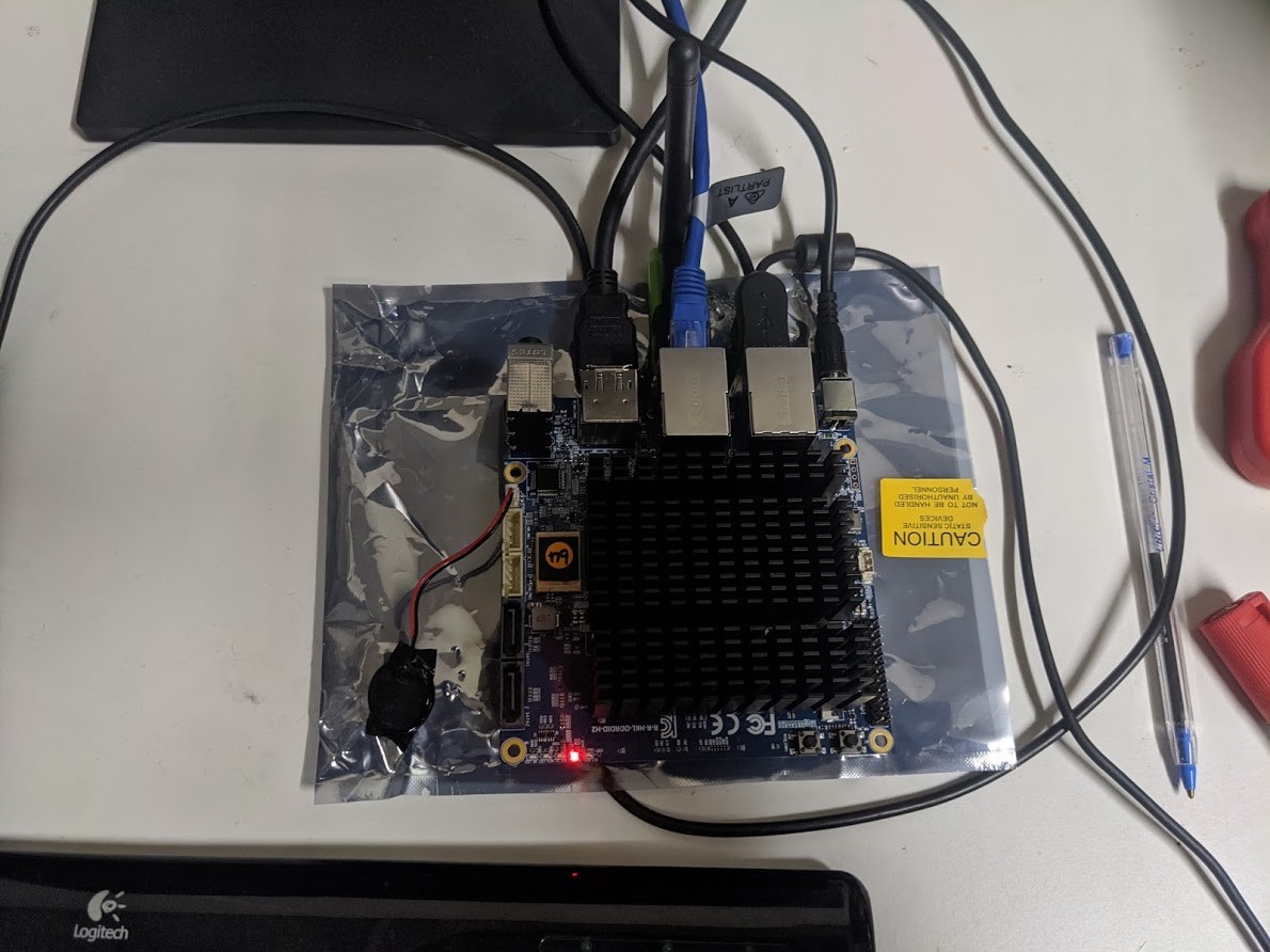

Odroid H2+ J4115 Celeron CPU, 2 NIC this has a 64GB SSD the size of your thumbnail and better latency than my Gigabyte Brix J1900
I think the Desktop PC is dead and replaced with Gigabyte BRIX and Intel NUC's. (The NUC I have even has a Radeon Graphics card!) and its mounted to the back of my monitor.
I think the laptop is dead and replaced by the Chromebook I am writing this on.
I want to buy another NUC to have at home.
I am looking forward to use the H2+ on my next CNC machine.
Replied by rodw on topic BeagleBone with LinuxCNC to replace old PC?
If you want small the Odoird H2 would make a good candidate.
