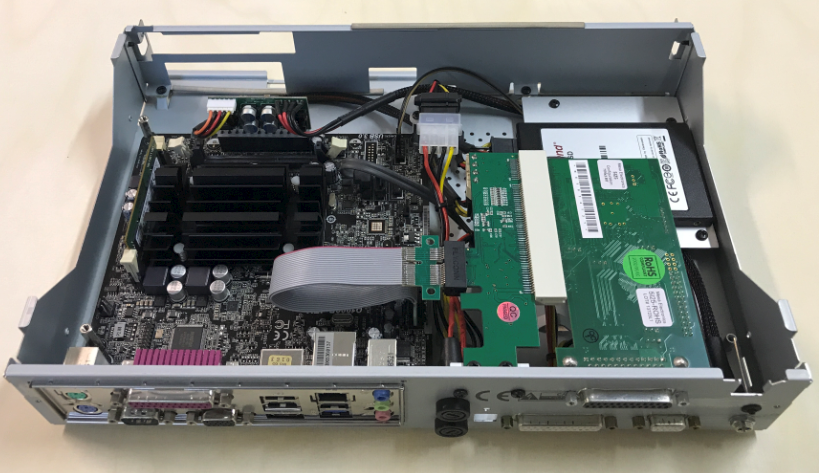

26 Aug 2020 16:03 #179586
by ississ
Replied by ississ on topic New motherboard
Yep, no need for any drivers. And fans or not, it depends...
This is my lathe controller built into an old Topfield box. There is about 12mm between the heat sink and the case and I added two 40x40x10mm fans on top of the heatsink blowing air out of the box just to be sure because the box is so small. The fans run as slow as they can.
Mill controller ended up in the same case with other electronics when the old P4 Dell retired. One 80mm fan on the back, again blowing out, was already in place running at full speed.
I have also a third one that is in a little smaller case than the lathe controller. That one has only an ssd and the power supply in the box. One 80x80x9mm fan spinning as low as it can.
These 3 are dedicated to their machines, there is nothing else than linuxcnc running (ok, samba for transferring files and vnc server for remote use).
No need for any additional setup before plugging the mesa, just assemble the controller and then fix settings and install linuxcnc.
I think my board run a bit too hot for my taste on the table during the initial tests so I added the fans. Also because of the small boxes...
Others have reported to run fine without fans.
I suggest testing when the controller is assembled, install lm-sensors and check temperature while the system is running and add fan(s) if it's running too hot. The temperature depends also other things in the box (power supply, ssd/hdd, mesa) and how much holes there are (and where they are).
