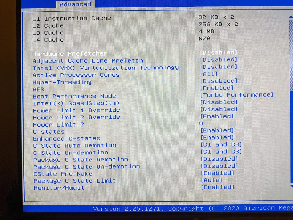

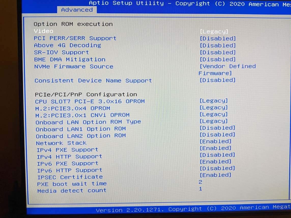

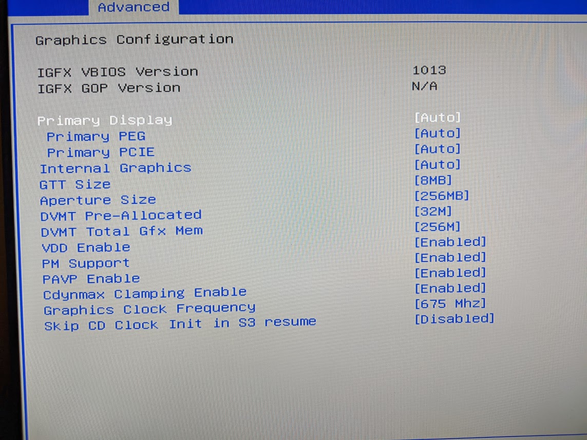

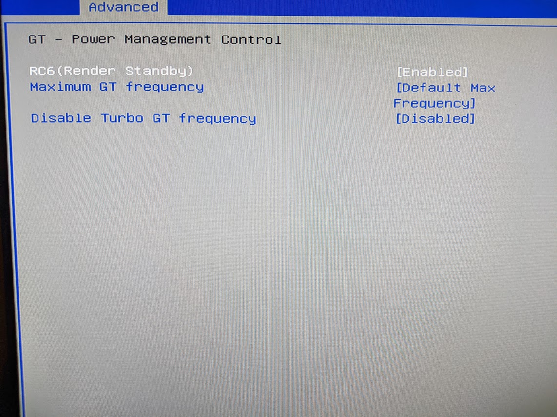

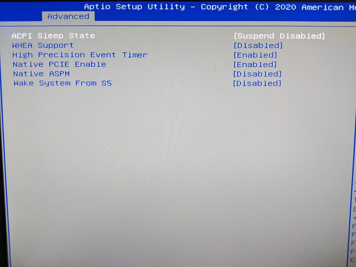

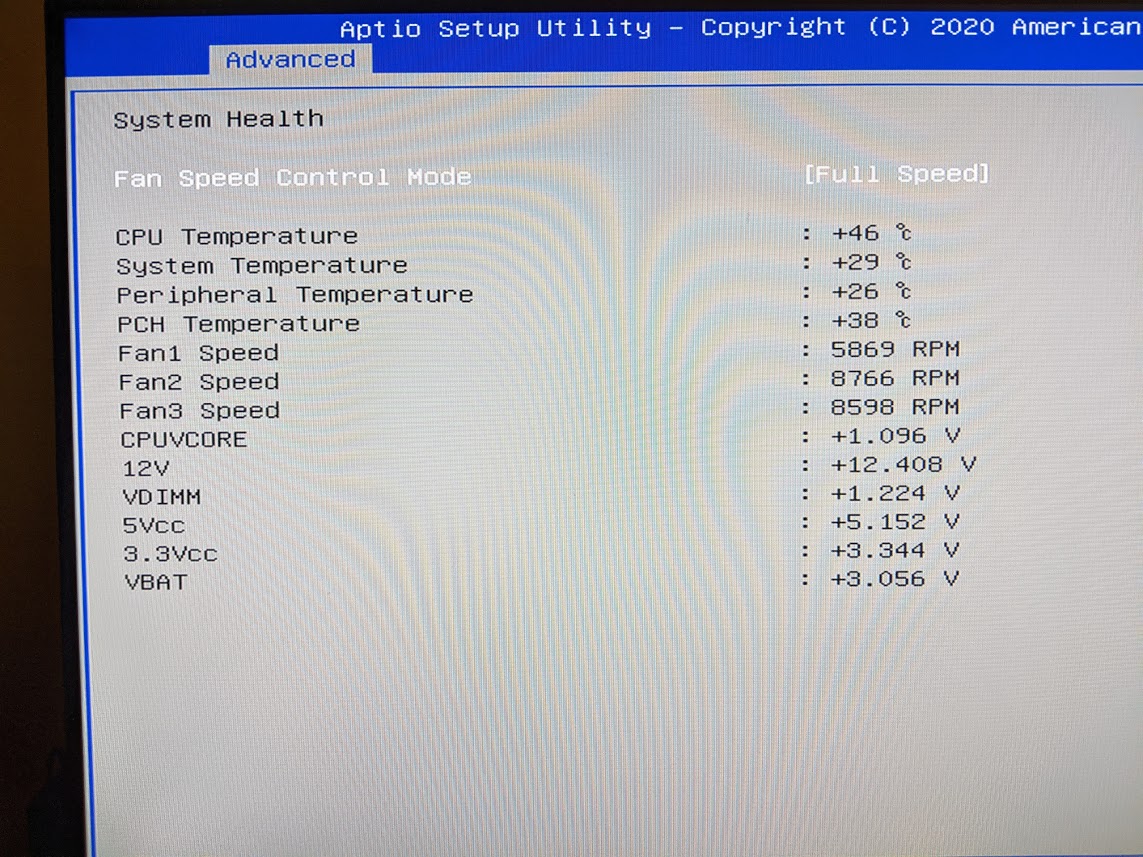

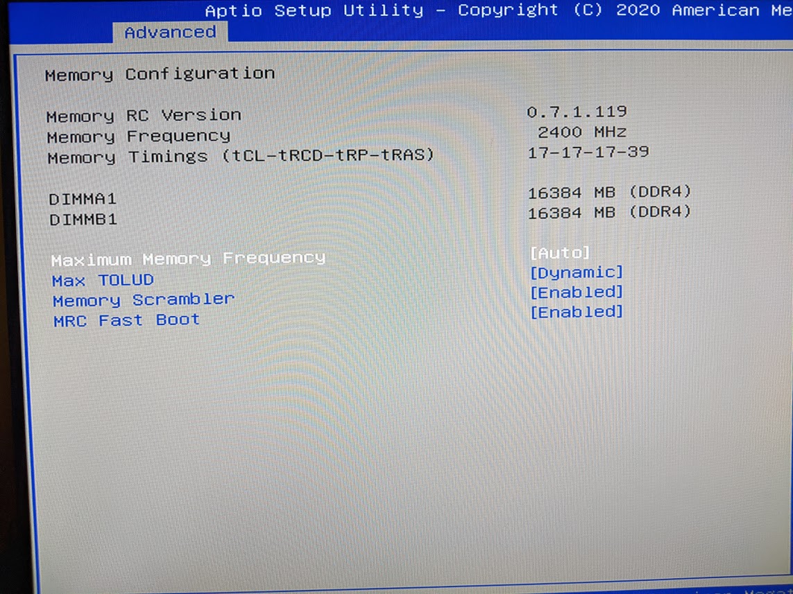

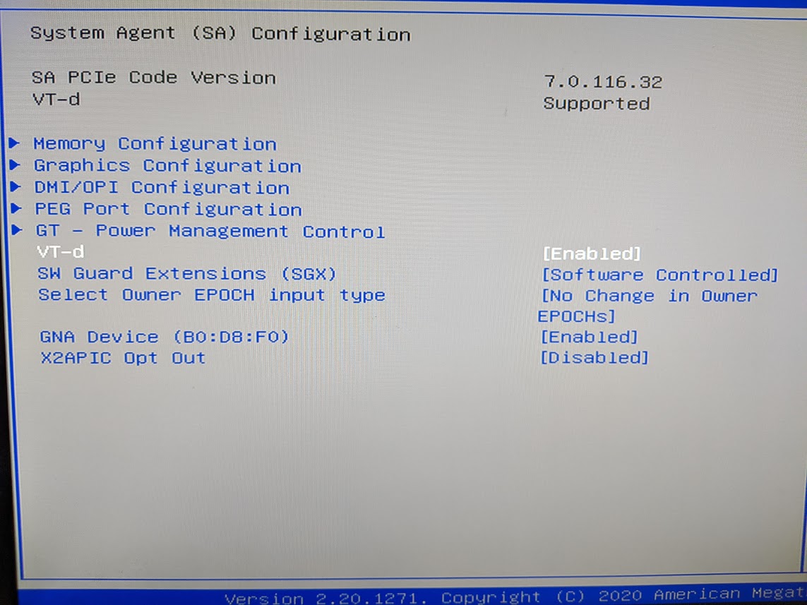

BIOS settings (pictures) was created by txtrone

Replied by Mike_Eitel on topic BIOS settings (pictures)
PXE is enabled when you want to allow network boot. Disable them.
I think the C states should be disabled as you do not want sleep modi.
VT-d is a virtualisation thing, believe its better disabled
RC6 is related to sleep modi, I gues better disable

11 Oct 2020 21:47 #185762
by txtrone
Replied by txtrone on topic BIOS settings (pictures)
Thanks! Made the changes and running a short 'stress test' at the moment.

hardware prefetcher = enabled
adjacent cache line prefetch = enabled
AES = disabled
boot performance mode = normal
power limit 2 override = disabled
everything C state = disabled or normal ???
monitor mwait = disabled
VT-d = disabled
RC6 render standby = disabled
DVMT pre allocated = 256MB
Max TOLUD = static or normal ???
Memory scrambler = disabled
AES = disabled
VT-d = disabled

11 Oct 2020 22:57 #185775
by txtrone
Power saving
Max Non-Turbo Performance
Turbo Performance
Option are:
OM
32M
64M
4M
then adds 4M through to 60M
Dynamic
1GB
1.25GB
1.5GB
1.75GB
2GB
2.25GB
2.5GB
2.75GB
3GB
3.25GB
3.5GB
Options are:boot performance mode = normal
Power saving
Turbo Performance
DVMT Pre-Allocated only goes up to 64MDVMT pre allocated = 256MB
Option are:
OM
32M
64M
4M
Max TOLUD options are:Max TOLUD = static or normal ???
Dynamic
1GB
1.25GB
1.5GB
1.75GB
2GB
2.25GB
2.5GB
2.75GB
3GB
3.25GB
3.5GB
- Posts: 21913
- Thank you received: 7466
12 Oct 2020 11:08 - 12 Oct 2020 11:10 #185816
Replied by tommylight on topic BIOS settings (pictures)
Was not sure about those as noted by to many ??? so id id some digging
1 max non turbo
2 i would set that and the one bellow it to the same value to avoid resizing memory during work, so both at 64
3 does not matter, leave it at dynamic, or set it at 1 and see if it does anything for latency.
1 max non turbo
Last edit: 12 Oct 2020 11:10 by tommylight.
