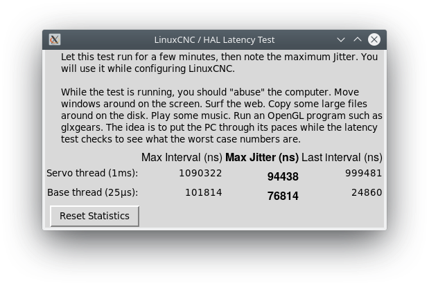

- JetForMe
- Posts: 310
- Thank you received: 27
14 Nov 2020 00:13 #189300
by JetForMe
Replied by JetForMe on topic KDE (Plasma) desktop freezes, but machine remains operable
So, I ran latency-test, opened up a couple YT videos, ran glxgears, and spent time just resizing one of the youtube windows. The machine froze. I rebooted, did the YouTube videos again without latencytest running, couldn't get it to freeze again. Started latency test, abused it some more, got some numbers, did a screenshot. Killed latency-test, ran latency-plot, and it spit out a similar message as LinuxCNC before (Unexpected realtime delay on task 0 with period 25000), and the screen froze again (I can still ssh in).
The latency-test showed:
Servo thread (1ms): Max Int 1503322, Max Jitter 503322
Base thread (25 µs): 381956, 356956
Not sure what to make of those numbers.
I think the weird window-server-freezing thing only ever happens if LinuxCNC stuff is running. But it's almost always running, so it's hard to be sure.
- Posts: 22049
- Thank you received: 7509
14 Nov 2020 03:52 #189310
Replied by tommylight on topic KDE (Plasma) desktop freezes, but machine remains operable
Check the processor cooler, remove it and clean and add some thermal paste then reseat the cooler, check if the fan spins freely.
Had similar issues with Cinnamon version of Mint that would freeze for no reason, the PC's are all good and Mate never freezes. So might be something with the DE.
You should change the graphic card, Nvidia are not a good choice for LinuxCNC due to many power saving stuff that can not be disabled.
