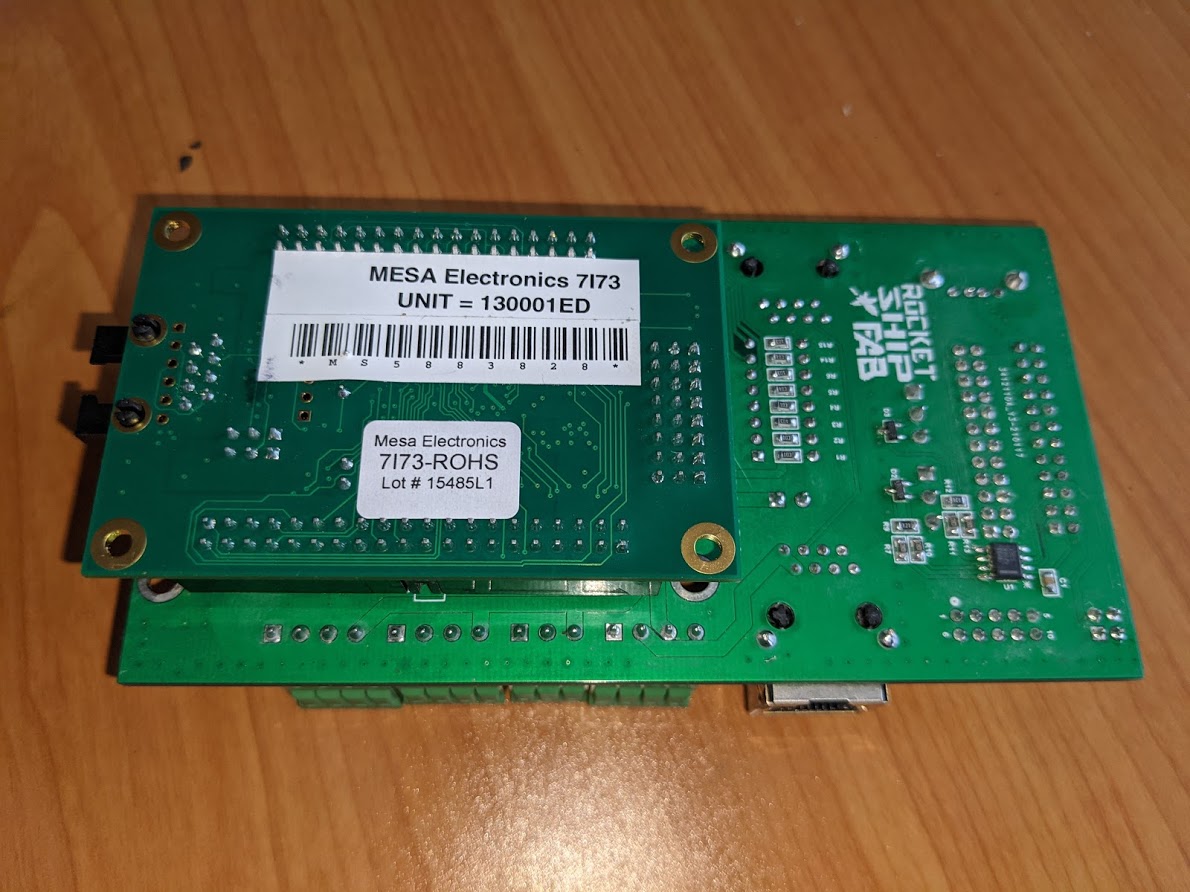

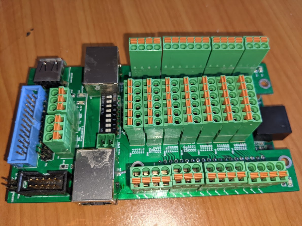

15 Feb 2021 05:43 #198919
Replied by rodw on topic Selecting a Motherboard/processor for Ethernet Mesa cards
If it helps, I have made a prototype breakout board shield for the 7i73 that also connects to the GPIO on an Odroid H2+. We have RS485 on board for plasma and VFD's, another Serial port and an extra USB connector. The last connector arrived today so I'll know soon if I got it right! I am going to use an industrial 6 axis wireless pendant (not USB) for the MPG as I have one on my plasma machine.
It won't be a cheap board as there are so many connectors as you know... Feedback welcome.
I was planning for this to be a seperate HMI with another control box on the machine for motor drivers and other mesa cards.

15 Feb 2021 07:30 #198929
by BeagleBrainz
Replied by BeagleBrainz on topic Selecting a Motherboard/processor for Ethernet Mesa cards
Looks good.
Glad you got all your bits and pieces.
Those push connectors work great once you get the hang, I found the boot lace ferrules make the job a lot easier, just a little extra labour to crimp them on but so much easier if you need to change things around.

15 Feb 2021 14:30 #198974
They were the only connector I could find that had stackable headers. but the price is not too bad..
Thanks for the feedback. The bootlace ferrules I have are 8mm long and they need to be 10mm to get a good grip so you reminded me there is something else to orderLooks good.
