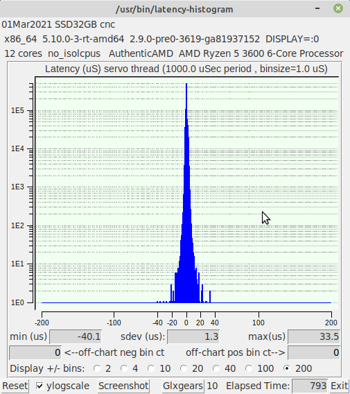

There are already two topic with some models that work and some that do not, but in general the "enterprise edition" PC's from Dell, HP and Fujitsu work almost always for Mesa cards. New PC's are a literal cr@p shoot, had a new Ryzen 5 system with very bad latency, brother has a Ryzen 9 system that is OK, and by now i had 2 other Ryzen 5 systems that work perfectly. The only thing that makes a difference there is the motherboard, cheap ones will not work, expensive ones do work.
This is the last one i put together some days ago, over 1000 Euro and still using an old graphic card and a low end CPU ! The prices have gone way further than NASA ever will.
