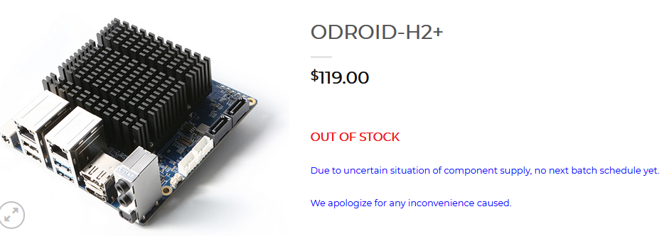

I'd be interested to know if you come up with a solution. Ever since I have been using linuxcnc I've been using fanless USFF PC's and even then the advise was to disable or remove the wifi card and run with a wifi dongle.
The Odoid H2+ is my fanless PC of choice these days. It has a UART onboard and I have a prototype board connected by a ribbon cable that adds a RS485 to the UART .

The Odroid H2+ is getting harder to get
was just looking to get one.
Asrock Q1900b-itx is a classic option if it is ok to work with bare motherboards.
The PC Andy links to has an Atom processor. What is the word on Atoms, are they ok
or is it better to go with Celeron?
I searched for "mini pc fanless" on Amazon and there are just too many to mention.
I would go for a celeron with 4GB mem, a small ssd, usb3 ports, at least one RJ45 ethernet and wifi.
