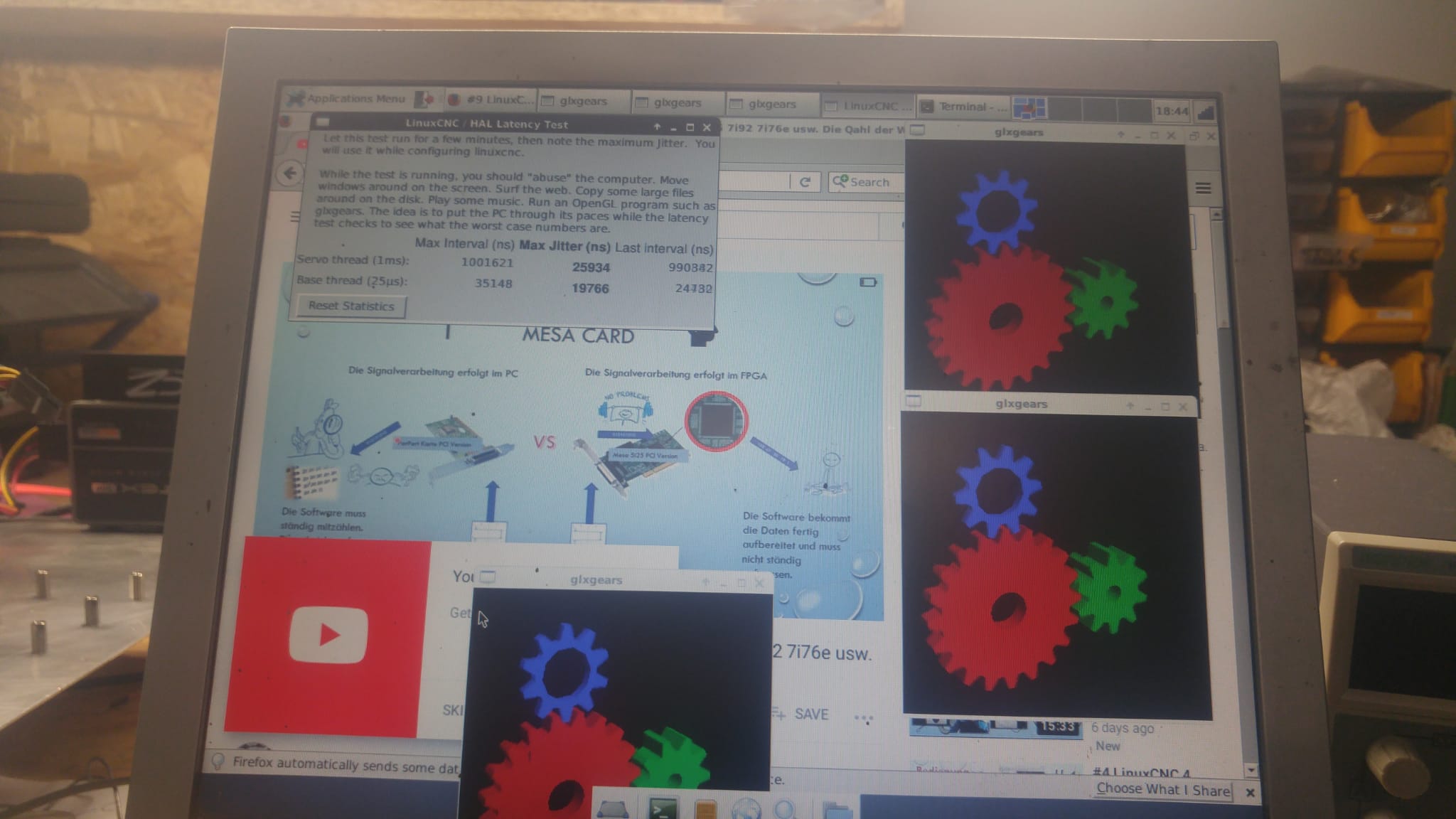

18 May 2021 13:03 - 18 May 2021 15:57 #209345
by ississ
Replied by ississ on topic Bad latency performance ASRock Q1900B-ITX
Quick test: I added "idle=poll isolcpus=2,3", reboot and test with 8x glxgears + youtube with a 2560x1440 monitor. About 1G/3.3G RAM used (this has only one 4G module, have to test with different memory configurations too).
Top shows core 0 & 1 ~5% idle, 2 100% idle, 3 ~35% idle.
Latency servo ~53k, base ~15k after about an hour.
Opening a new firefox window + another youtube did not affect latency values at all. Cpu usage increased a little.
Seems that isolating cores is the thing to do, probably need to go through different sets to check which one performs best.
Update: I tried different isolcpus and 1,2,3 gives best latency. 2,3 is the next best, now servo 31k, base 25k after 4 hours with same load as above. I'll let this run for tomorrow.
