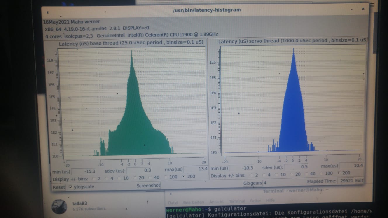

now I have to ask:
which text file do I have to edit,
google for a while now. but somehow not get any further

Replied by ississ on topic Bad latency performance ASRock Q1900B-ITX
To change kernel command line ?
/etc/default/grub
This is the default:
GRUB_CMDLINE_LINUX_DEFAULT="quiet"
Modified:
GRUB_CMDLINE_LINUX_DEFAULT="quiet isolcpus=2,3"
My system has now run ~6 hours, latencies: servo 31k, base ~31k with isolcpus=2,3.
I think this is enough, with isolcpus=1,2,3 ui feels slower. Tomorrow I'm going to test with some other window manager and different memories.

Replied by DoWerna on topic Bad latency performance ASRock Q1900B-ITX
Done,
that seems to have really helped now.
I'm still running the test, currently I have latencies of less than 13K with 2 cores
Let's see if the values still low, but for now it looks very good
Problem probably solved

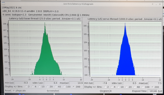

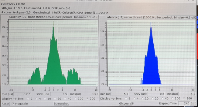

I'll continue here with the memory tests:
1x 4G Samsung M471B5173QH0-YK0
2x 8G Corsair CMSO8GX3M2A1333C9 1333 Mhz CL9
2x 8G Hynix HMT41GS6BFR8A-PB 1600 CL11
No image, huge spikes quite far from center on servo thread, I say these should not be used.
1x 8G Corsair gives similar image as the 4G Samsung but a little worse latency.
=> So a big difference by just changing the memory.
These Corsairs are 1.5V (others 1.35V) and lower CL value. I belieave that optimal setup would be a low CL memory with 2 identical modules.
