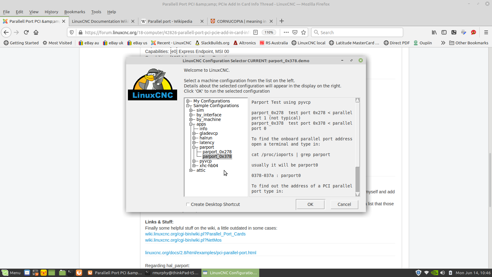

Parallel Port Tester
wiki.linuxcnc.org/cgi-bin/wiki.pl?Parallel_Port_Tester
A tester can aslo be found in the Linuxcnc Config Selector
