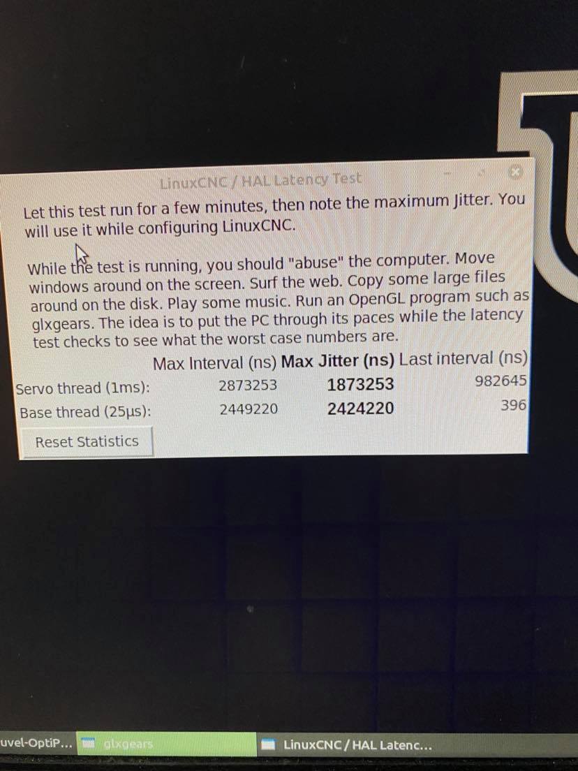

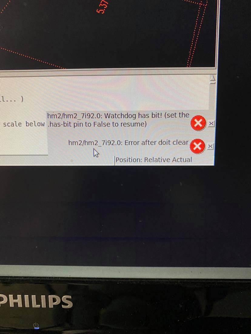

Terrible Dell Optiplex 7020 i5 RT kernel 7i97-7i77 was created by bevins

Replied by PCW on topic Terrible Dell Optiplex 7020 i5 RT kernel 7i97-7i77
Wow, the first screenshot shows ~6 millisecond jitter
I would almost think that's not running a RT kernel
Power management can cause latency spikes of that magnitude
so I would make sure no speed-step, C states > C1, or turbo modes
are enabled
are enabled

02 Jul 2021 04:36 #213485
by bevins
Thanks as always for your wisdom Peter.
Replied by bevins on topic Terrible Dell Optiplex 7020 i5 RT kernel 7i97-7i77
lol, yeah.... at the risk of sounding stupid, which I probably already do, it wasn't running the right kernel. I updated grub but for some reason it wasn't booting the right kernel and I didn't check. I just assumed it was. So I manually updated the grub file and it works.Wow, the first screenshot shows ~6 millisecond jitter
are enabled
