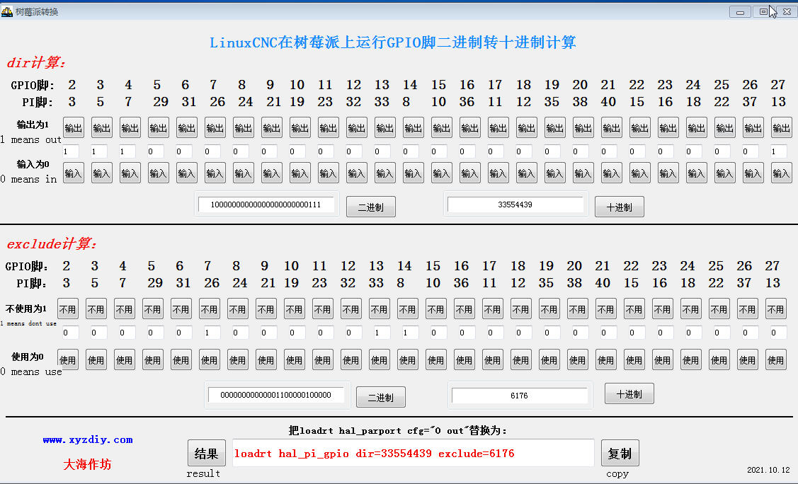

Write software, you can try
- diy
- Posts: 5
5 years 2 weeks ago #223283
by diy
Replied by diy on topic Rpi4 HAL question
download
- CatoFu
- Topic Author
- Posts: 4
5 years 2 weeks ago #223383
by CatoFu
Replied by CatoFu on topic Rpi4 HAL question
Thank you elovalvo!
Cato
Cato
- CatoFu
- Topic Author
- Posts: 4
5 years 2 weeks ago #223384
by CatoFu
Thank you diy!
I will try it.
I will try it.
