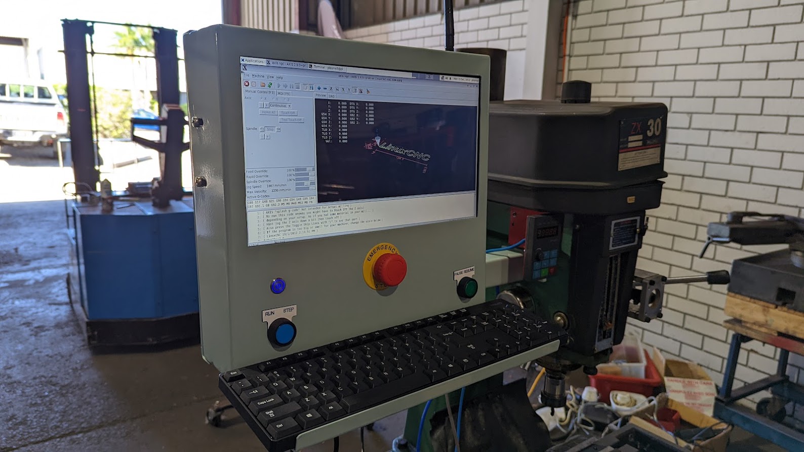

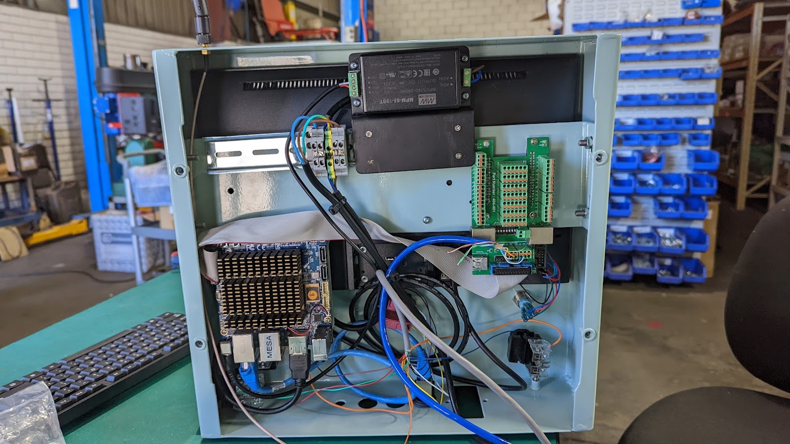

I am on Robert's side here. I use something similar with 4 gb RAM. It has dual NIC's, twin serial ports and twin external wifi antennas.
J1900. I think with the newer OS builds, maybe a higher spec as he says with 8 gb Ram.
It is a shame the Odroid H2+ was canned as the faster J1415 Celeron CPU is a better candidate. You could still use one of these fanless PC's as I have done here with the Odroid.

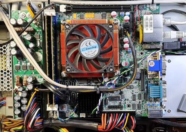

I had 3x Q1900-ITX and they worked well with the old rtai kernel. However they have quite bad latency with the newer os so no-go for an upgrade.
Fortunately I found a couple of WADE-8012 industrial boards (13-2100, dual nic, 4Gram). These seem to work well, the only downside is that a fan is needed.
