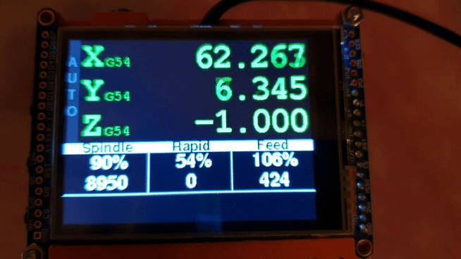

I'm making good progress on the Python Interface manualmatic pendant[1] - but there are a couple of machine values that I can't seem to access. The first relates to jog values - I can sorta understand that because jogging is always UI driven.
But the second is rapid speed. I can get feed speed from linuxcnc.stat().settings[1] (from the Python Interface docs [2]) but settings[2] gives me spindle speed - which I can already get from spindle[0]["speed"].
Is there a rapid speed value? Am I missing something obvious? If not, can I please request it is included in 2.9 (as settings[3] perhaps])? I'd like to be able to contribute to the interface if that would help, but I have not yet found in the github source... (all hints or links welcome!)

Hi Kyle - thanks for your reply - I'm trying to take advantage of the userspace Python Interface to create an almost plug and play pendant for Arduino/Teensy - that only requires one file (maybe two) and a single line in the custom.hal but will work for all UIs without any changes or net pin configuration.
I'm more confident it will work now than when I posted the proof of concept earlier (link [1] in the first post) - I have the manual mode sorted and making good progress on the auto mode - even though I'd like the rapid speed to display on the pendant, I'd rather lose it than have end users have to create custom pins (although there is likely a way I could build it into the component).
In the Python Interface the command().rapidrate() sets the scale (1 = 100%) but I need the base speed to calculate the overriden speed, as per feed speed and spindle speed. I don't think I have the option to set count-enable.

08 Jan 2022 07:09 #231109
by fletch
Replied by fletch on topic Python Userspace Interface Rapid Speed value?
Aha! Logging this for anyone interested.
max_velocity - from [TRAJ]MAX_VELOCITY was a big disappointment - ini files now appear to set MAX_LINEAR_VELOCITY so max_velocity always returns 0.
However, I somehow missed stat().current_vel which in combination with motion_type (value of which changes when running a program) should give me both the actual feed rate ( MOTION_TYPE_FEED) and the actual rapid rate (MOTION_TYPE_TRAVERSE).
We shall see - and I still have to work out what to do with the other motion types (esp arc).
