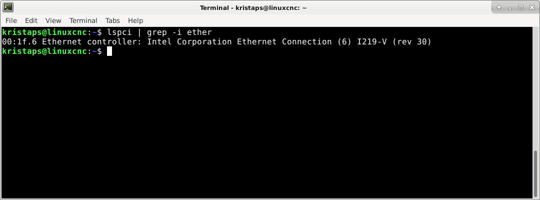

Using Intel NUC to run mesa 7i76 card.
Model BOXNUC8I3BEK2 (i3 with ssd hdd and 6gb ram.)

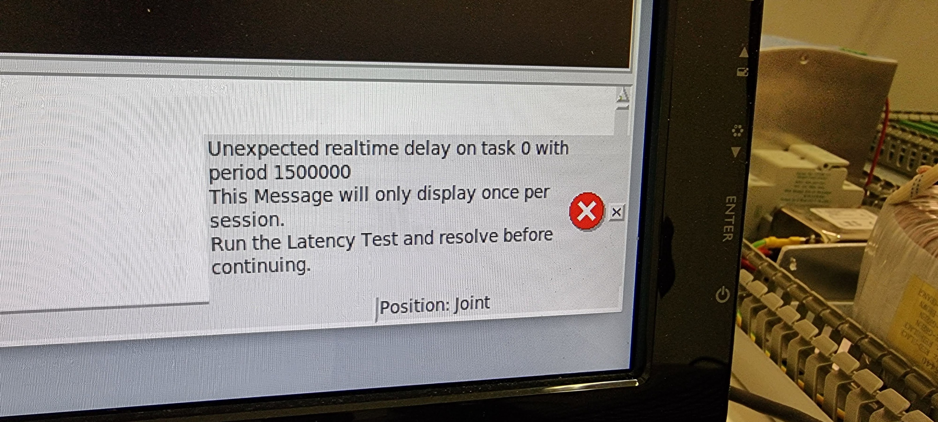

Im having trouble with servo period and mesa card 7i76. It shows error when its at default value of 100 0000.
Need to adjust over 170 0000 to error go away.

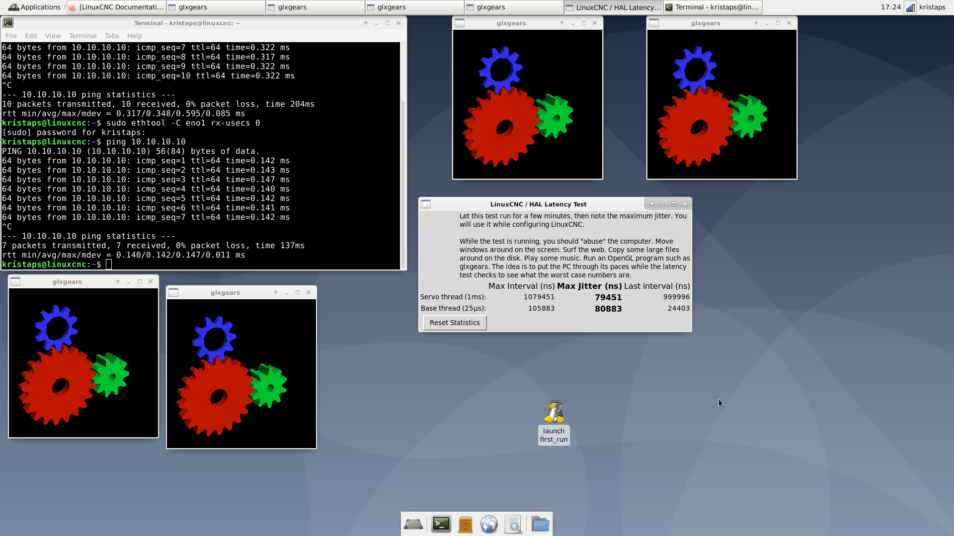

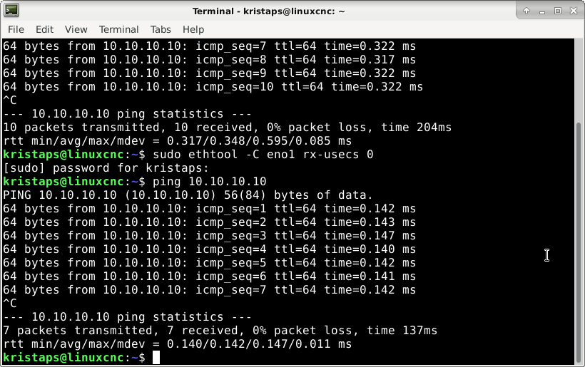

Did some more tests today.
In bios i already had disabled many things. Audio, Bluetooth, turbo etc.
With coalescing disabled ping was x2 better, but eventually it didn't resolve servo thread problem.I couldn't go lover than 1600000.
Sometimes opening and closing multiple times linuxcnc error didn't show but but thats not reliable.

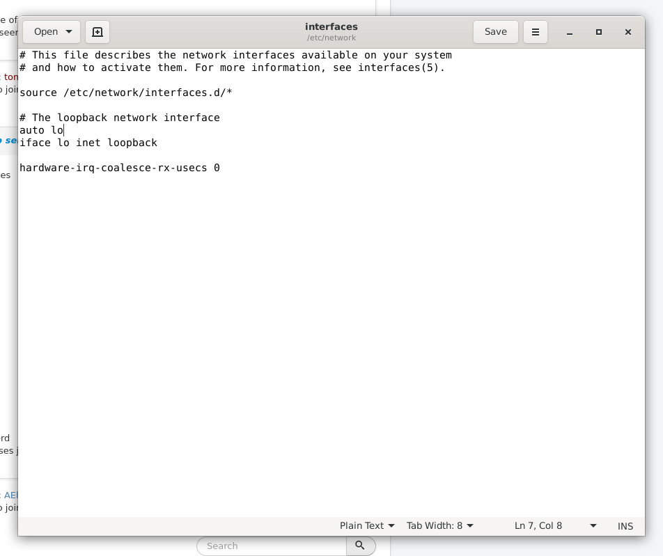

How to properly edit this so i dont need to run command from terminal?

You need to specify the interface for the driver setting
for example
auto eno1
iface eno1 inet static
address 10.10.10.100
hardware-irq-coalesce-rx-usecs 0
for example
auto eno1
