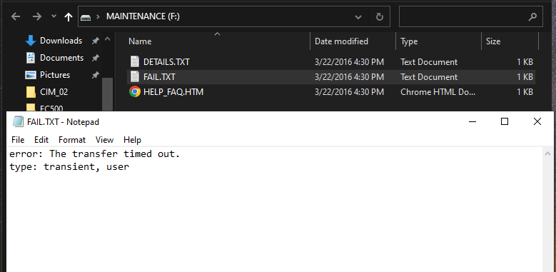

- REX299
- Visitor
01 Feb 2023 09:39 #263428
by REX299
Replied by REX299 on topic Remora - ethernet NVEM / EC300 / EC500 cnc board
Hi scotta,
I just got St link today, following your video to create DAP link, Step 1 working, my computer shows 2nd ST link as removeable storge, But I have problem with Step 2. When I finished drag "stm32f103xb_mimxrt1050_qspi_if.bin" file to storge, nothing happens until I try to open one of 2 files on Maintenace, it reset itself then show fail log file.
Fail log file:
"error: The transfer timed out.
type: transient, user"
Any idea?
Thank you.!
Fail log file:
Any idea?
Thank you.!
