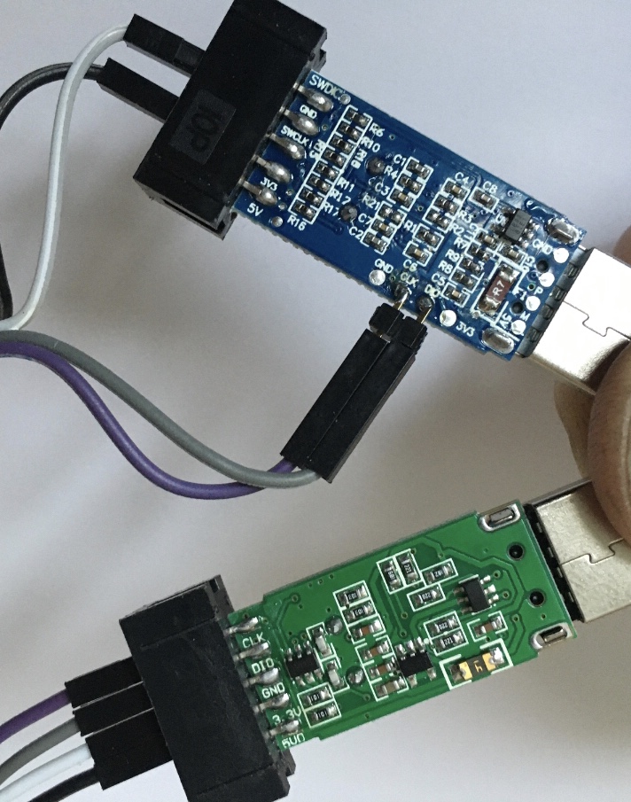

- heiterkiter
- Posts: 3
28 Jan 2023 09:37 #263063
by heiterkiter
Replied by heiterkiter on topic Remora - ethernet NVEM / EC300 / EC500 cnc board
here is a picture of the wiring. i turned everything around for viewing pleasure. the dupont cables are connected to the pin rows shown
3v3 to 3v3
GND to GND
CLK to ClK
DIO to DIO
the boards are exactly like yours. the source board has a solid blue LED and the target a flashing red LED
just tested again. no luckl. :/
3v3 to 3v3
GND to GND
CLK to ClK
DIO to DIO
