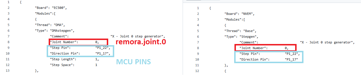

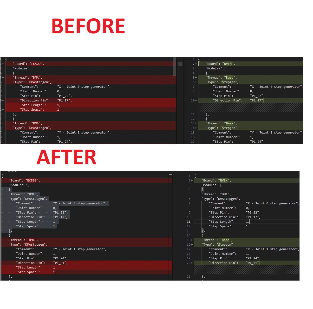

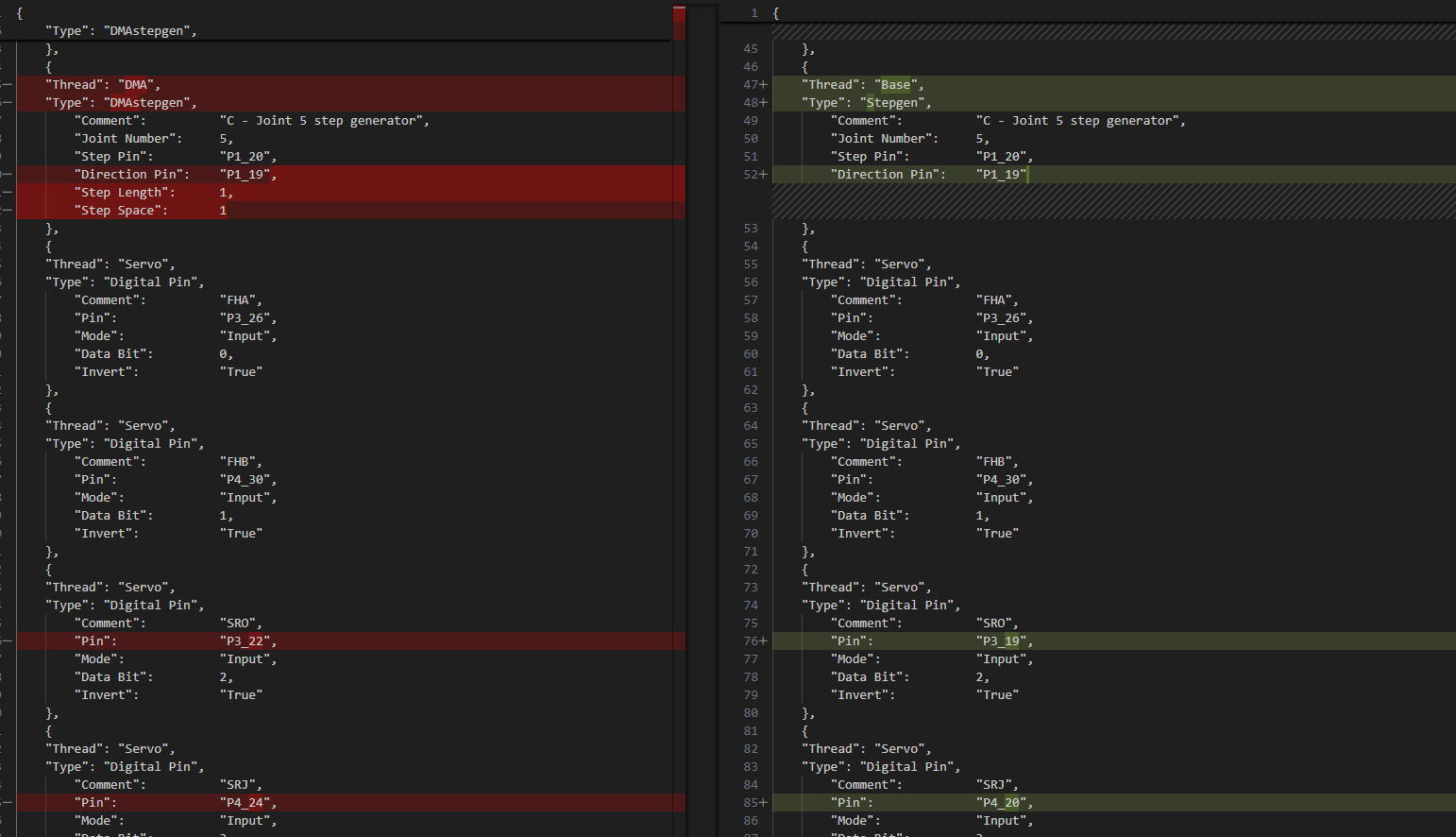

06 May 2025 00:02 #327804
by cakeslob
Replied by cakeslob on topic Remora - ethernet NVEM / EC300 / EC500 cnc board
Pgain and ff1 and deadband are parts of the remora stepgen and used to tune motor control/feedback. feedback control has nothing to do with encoders or input from the motor. it is an internal math shit connected to the stepgen to tune motor position control like you would a servo.
regular stepgen and DMA stepgen have no difference in LinuxCNC. The same concept as inputs applies to the stepgen/dma stepgen. In the Config.txt you tell the MCU that pin P1_22 and P1_17 is step and direction of joint 0, which is remora.joint.0 which is connected to LinuxCNC joint.0
The DMA stepgen is a faster hardware based stepgen and requires dedicated hardware pins. LinuxCNC does not know if you are using DMA stepgen or regular stepgen and it does not care.
Looking at the EC500 DMA stepgen config, we can apply the same concept to the NVEM config.txt The config.txt for your specific board, and is just a way to tell the remora what pins do what. The default stepgen is regular stepgen because it is less to tune. If you want to change your stepgen to DMA stepgen, lets compare the config.txt DMA stepgen and apply it to the NVEM config.
If there are no hardware conflictions (there arent in this case) we can go about changing the stepgen to DMA stepgen. In this case the pins are the same for both boards. so replace your entire stepgen with the DMA stepgen and make sure the pins match the pins on your board

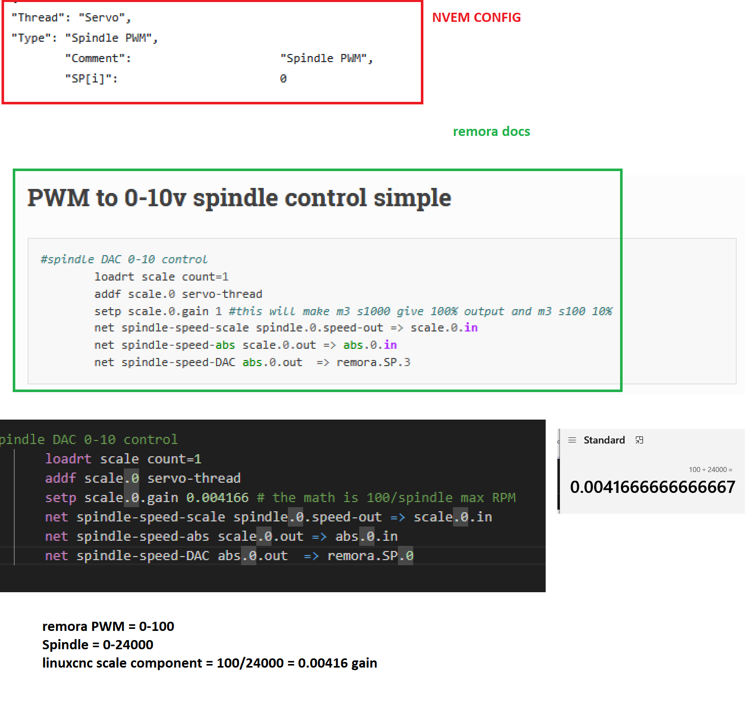

Where can I find an example of how to connect and integrate a handwheel (MPG)? Is it possible with Remora to use both a handwheel and an encoder for the spindle, or is only one of the two possible?
The background is that I drive the spindle with an AC servo, and this should be controlled via step/dir as a C axis. In the Gcode, the spindle should then work as a C axis, depending on the call, or rotate as a spindle. For the C axis to function correctly, not only the index must be evaluated, but also the angle via A/B.
EStop tested on NVEM board, works with mushroom button. In the GUI, EStop can be released and the machine started if the switch is not pressed. If it is pressed afterwards, the machine goes back into EStop.
Thanks to the "stupid" AI, I now seem to have managed to get a command to be issued on Joint2 with G0 C10 or with an M3 S300.
