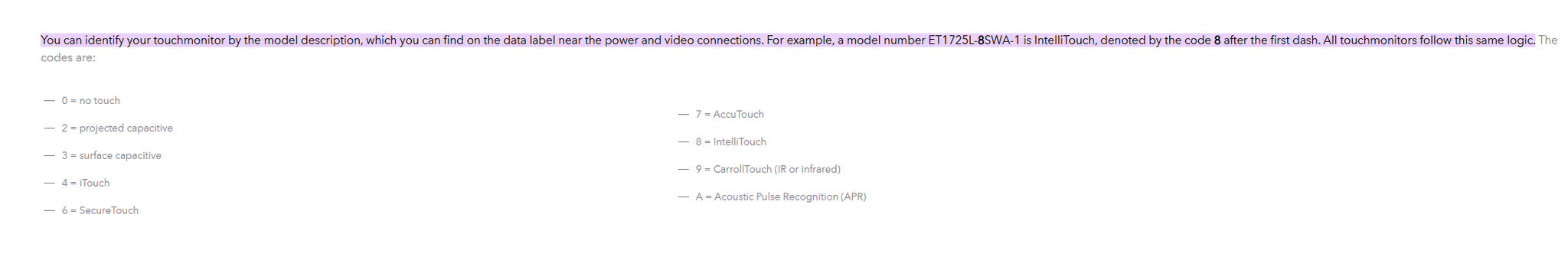

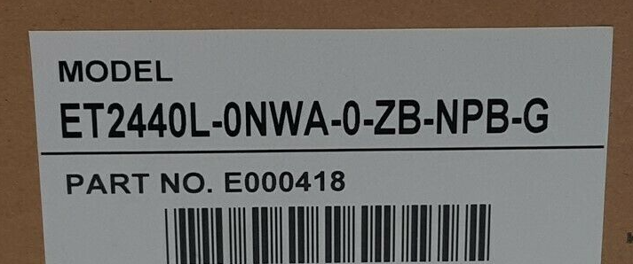

I have been trying to install my new touchscreen. My old ELO 17" has worked awesome for the last 8 years, it's getting darker and darker so I got a newer one. I picked up a ELO ET2440 since I'm really wanting to go to SilverDragon.
I didn't have much of a challenge getting the old one which is USB connected going with 2.8 and Buster. This new touchscreen I can not seem to get rolling. It doesn't show up in lsusb even after having the other monitor running and a computer restart. I'm not sure if I have a conflict between the two units. I used the below instructions, I can not get the elotouch software running. When I get down to "systemd status elo.touch" I get a failed return.
I did attempt to install with the 64bit Intel/AMD driver.
Does Debian Buster use systemd ?
It appears that libusb is already installed as the default package. I added Motif 3.0.
Hopefully I'll have the new console completed over the next couple days and get back to trying to get the touchscreen going.

did you get that on ebay? I have a customer who grabbed one for what seemed to be a great price, but he found that it was not a touch screen but a non touch model even though the listing stated touch. below was the model he purchased and he couldn't get touch working so he discovered the below information on the elo website:
hope that isn't the same case for you!

Well that sucks.
I have the same one. One way or another current monitor on the machine was on the way to the grave. Yeah I could have caught that on the part number. Touchscreen in the description is deceiving. Well I feel better that I couldn't get it to work! I guess I'll use that one for something else and hunt down another one. It does look great in the console!

sorry to hear that, but at least you aren't beating your head against the wall trying to sort it out. I would contact the seller and return, that is what m buddy did with seller paying shipping. it was 100% falsely advertised!

I have a working touchscreen now. Much better when you buy one that is actually a touchscreen.
