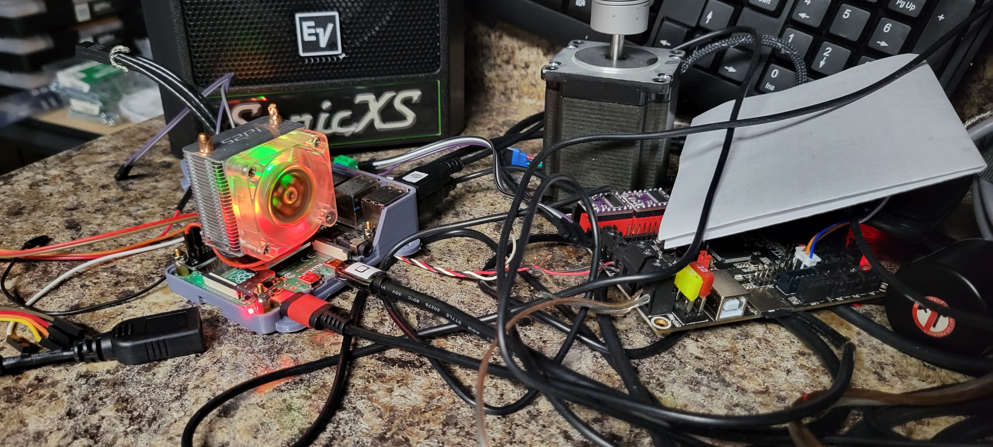

Also some of us put fans on our RPI4, its not needed but i like to overclock it to the max and then some.
Also its adorable.
Also its adorable.
