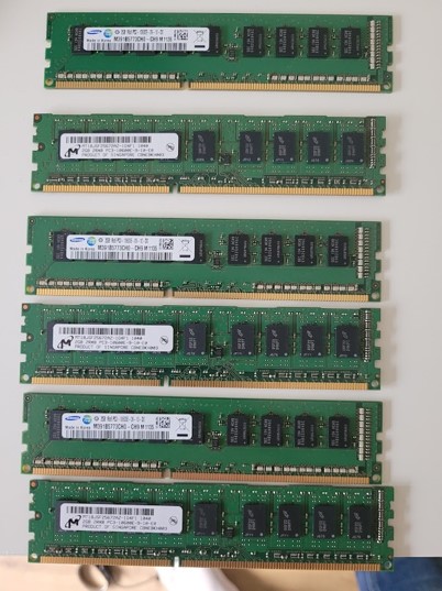

Dear forum members,
I have started a trial to realize a LinuxCNC based DC servo setup, as a trial for an intended self-build CNC mill. While doing so I have frequently visited this forum and the Linux CNC documentation for info, which already helped me a lot. Unfortunately my LinuxCNC installation keeps crashing after a small period of time. Initially I thought this was because I used a demo simulation, however even now I have completely configured a MESA 7i76e using Pncconfig I still run into the same issue. I tried various things based on the information I found here and elsewhere on internet, however I am new to using Linux and thus far none of the things I tried were successful. Via this route I hope someone with more experience in debugging hardware is willing to give me a couple of hints... I will try to start describing the issue I encounter: When I start Linux all go's well and I can do what I like (such as writing to this forum). I can also start-up LinuxCNC and if I do nothing after this will stay responsive for a short while. However after some time (couple of minutes) the program freezes and with it all of Linux. The only thing which will still move is the mouse pointer. When I zoom in and out a couple of time just after I started LinuxCNC I get the impression the error occurs faster and usually the system freezes after only a few times scrolling with the mouse wheel. Latency test gives something like 9000 for jitter on servo thread and 14000 for base thread.
The workstation I use to run this LinuxCNC installation is an HP Z400 workstation with an NVIDIA GeForce 660 GTX 660 Ti graphics card (this HP motherboard has no onboard video). The latter is a "usual suspect" if I understand well, however I also read that as long as the mouse cursor still responds the cause can't be the video card. The Linux version installed is SMP PREEMPT RT Debian 4.19.146-1 (2020-09-17).
After some more reading I thought that the freezing might be caused by overheating of the CPU. I changed the fan idle speed in the HP bios and monitored the cpu temperatures using lm-sensors and the "watch sensors" command in a terminal. This didn't show a significant increase after starting LinuxCNC and during the time up to the next freeze (around 55 deg. C, with high = 80 deg C). So it doesn't look like CPU heating is the issue....
I then found some exhanges on CPU idle states, the so called 'cstates'. Using some online source I found out that the CPU idle driver used on this installation is "intel_idle". Based on further information I found I added the kernel parameters "intel_idle.max_cstate=0" (to disable the intel_idle driver) and added the kernel parameter "idle=poll". Unfortunately this didn't solve the issue of LinuxCNC freezing after a while. Now I am more or less lost... Which is a real pitty because I do think the MESA 7i76e is working (mesaflash on terminal provides nice feedback) and by now I have a single DC servo working with a DG4S-16035 driver and connected to one of the mesa step/dir channels. I would love to get this connected to LinuxCNC and get some confidence in that I will be able to make this work before I buy additional hardware.
Any suggestions in how to do further efficient fault finding is highly appreciated. Note that it might be something "obvious" related to Linux as I am a very very unexperienced user on this operating system...

Remove all but one memory module, test all modules one by one.

Dear Tommylight and katedayle,
Thank you for your suggestions, based on your reply I opened up the HP workstation and did some further research on internet about RAM DIMM modules and how these can be configured for the Z400 motherboard I have. While taking the DIMM modules out I noticed they were not identical and initially I had a hard time finding out why, as each module stated it was 2GB. After some searching I found out that there are "dual rank" and "single rank" modules and that my motherboard supports a total of number of 8 "ranks". Terminology is still a bit vague for me but you can recognize the dual rank ones as these have chips on both sides. On mine it states either 2Rx8 or 1Rx8. As I have 3 of each I can install 8GB (in total = 3x1+1x2= 5 ). I also read that for optimal performance some claim it is best not to mix dual rank and single rank DIMM's. HP provides info on which of the six slots to use for 3 DIMM's with 2GB each (these are 1, 3, 5 and take care the numbering of the slots is a bit odd...). I have tested a whole bunch of combinations, but unfortunately none of them solved the problem. With only one 2GB DIMM module installed in the first slot I got the impression that the system kept working the longest, however this time the ui really got scrambled in the end (in the graphical part of the window several images got copied over each other and numbers became unrecognizable) . Most other combinations showed the same result, namely that the complete system became unresponsive, while I was only able to still move the mouse. Even if I completely replaced 6GB (the 3 modules in single rank) by 6 GB from other modules (the 3 dual rank ) the issue remained. From this I tend to conclude that the DIMM modules are not the (only) issue.
None the less thanks for providing these hints, as a starter this really helps a lot. For now I will try to follow the other suggestions provided in the hope this gives me further hints on what is going on.
