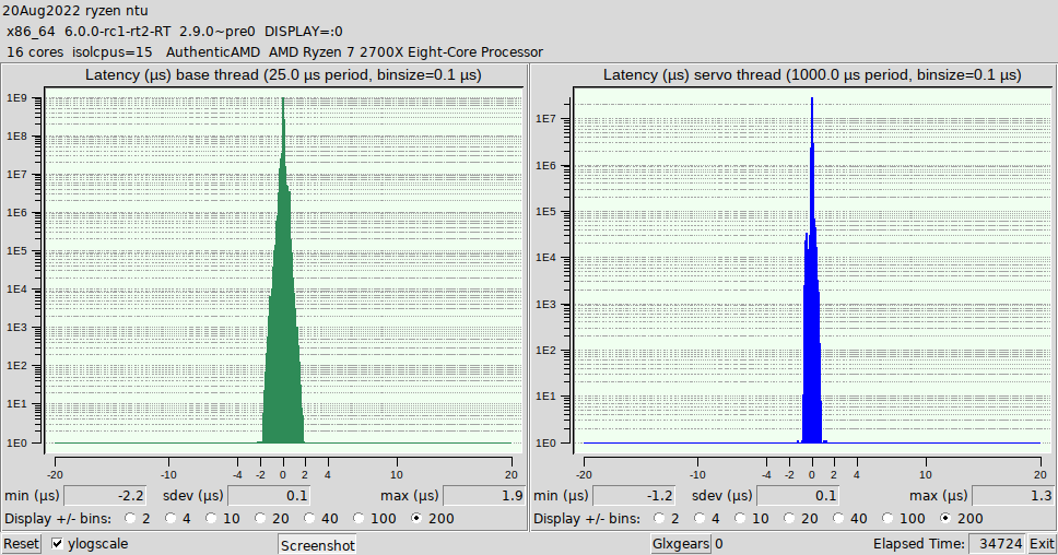

First preempt_rt Tests with 6.x Kernels

On a related note, Phoronix recently had a notice about getting closer to
PREEMPT_RT support in the mainline kernel
. "Just 50 out-of-tree patches remaining."
