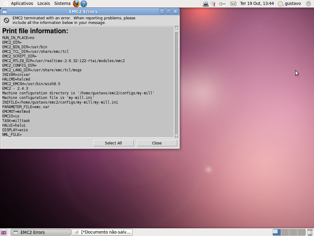

Hello all,
When I try to run EMC2 on my notebook (Compaq Evo N620c), the following errors are shown:
Can anybody help me ?

Replied by BigJohnT on topic Re:EMC2 startup problem
Looks like the real time system did not load. Did you do a fresh install from a LiveCD?
Also, notebooks are not suited for machine control so if you just want to get the feel of EMC install the sim version.
John
John

Replied by step4linux on topic Re:EMC2 startup problem
It seems to be the well known apic/lapic problem
You will find here in other threads help how to solve it.
www.linuxcnc.org/component/option,com_ku...8/lang,english/#4205
Gerd
[ 0.000000] Local APIC disabled by BIOS -- you can enable it with "lapic"
[ 0.000000] APIC: disable apic facility
Gerd
